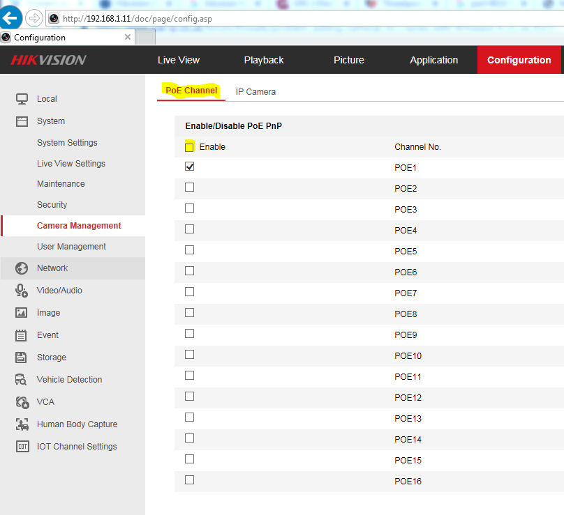

No problems my side adding cameras with v4.21 at present. However, when I upgraded from an earlier firmware to v4.21.005 I had to re-enable the PoE Channels for some reason.
2347
Thanks Stew - checked that at the time and they were/are all enabled. Three cams with the same problem is awfully strange. I've had some odd quirks since upgrading from 4.1.64, so I'm sticking with it until I see a good reason to change. Just too many issues.
