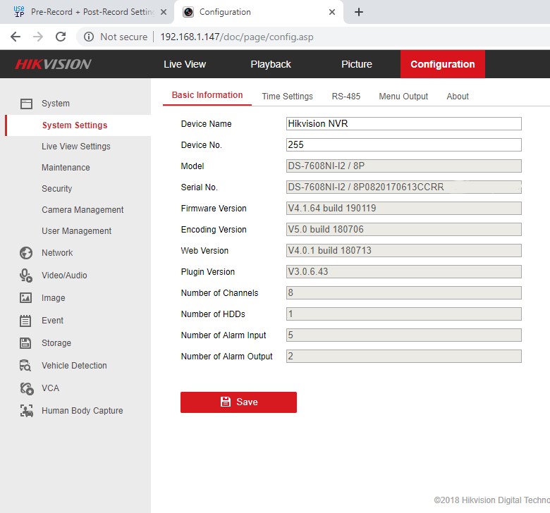

DS-7608NI-I2
V4.1.64 Build 190119

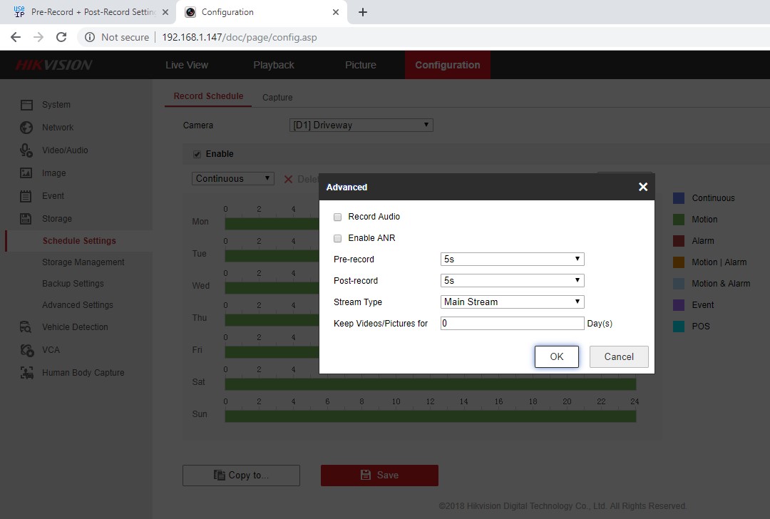

Recording Schedule set to Motion Record 24/7

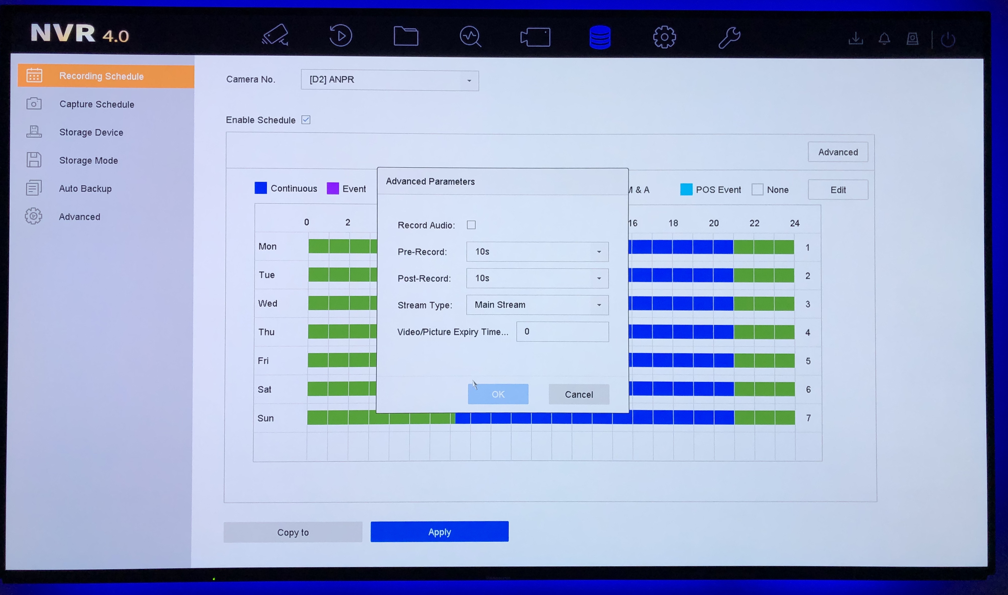

Advanced Settings:
Pre-Record 10s
Post-Record 10s
Recorded Activations are only showing the motion event and no pre or post recording.
Is there a setting I have missed?
Thanks guys

I have tried all manner of settings and still cant get the Post / Pre recording to work since upgrading to V4.1.64 build 190119.

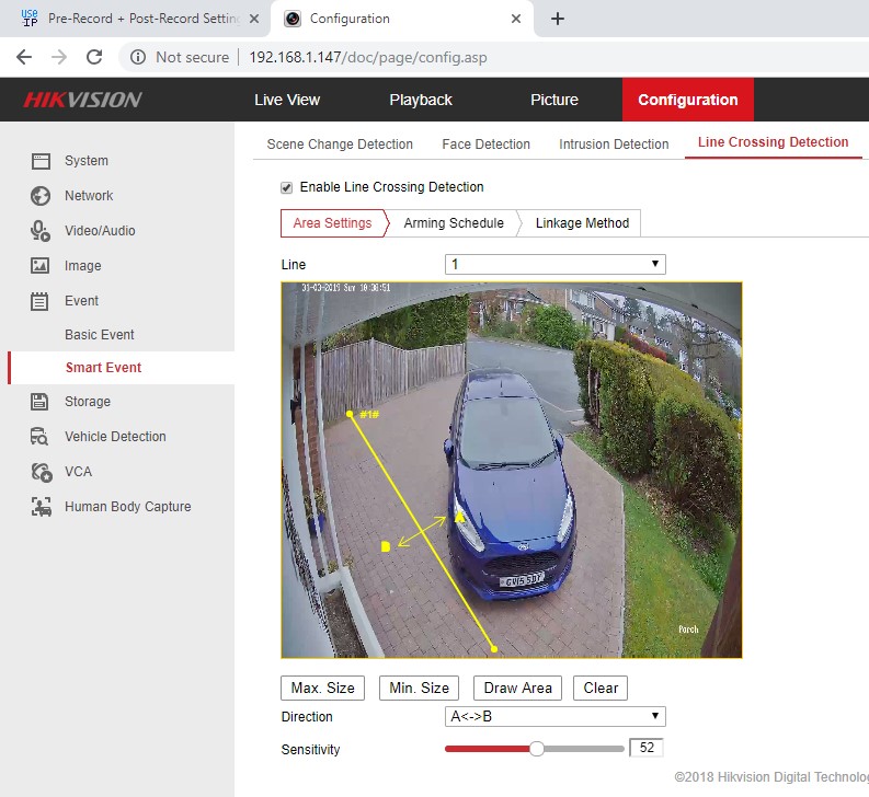

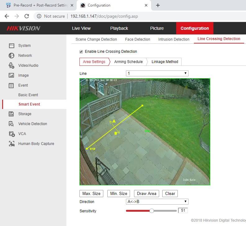

Its very irritating as when a line crossing activation is sensed I get an instant push notification of the event but when I go to view the footage its blank.
Also when I clean the lens on the driveway camera it doesn't show me cleaning the lens, only me walking away from it, which is totally unacceptable (no post record) :(
I only have x2 cameras set to line crossing out of a total of x8 cameras..
Im running Firmware V4.1.64 build 190119 and my known problems are:
1.. Post/Pre record not working (Have now set to 5s and still not working)
2.. Line crossing showing no footage recorded (linkage method "Notify surveillance centre" + "trigger recording channel D*)
