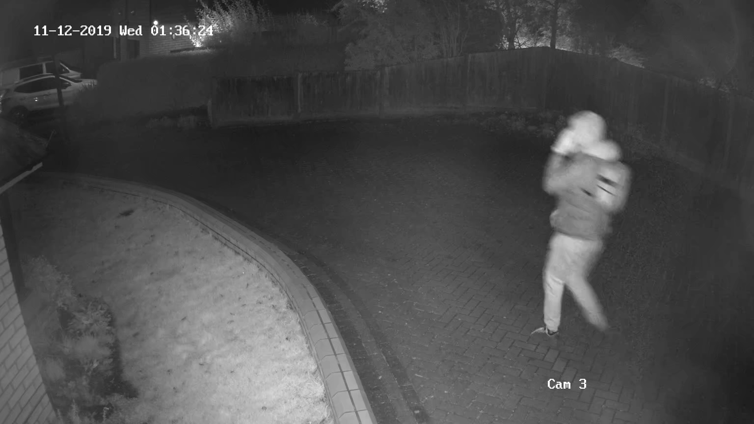

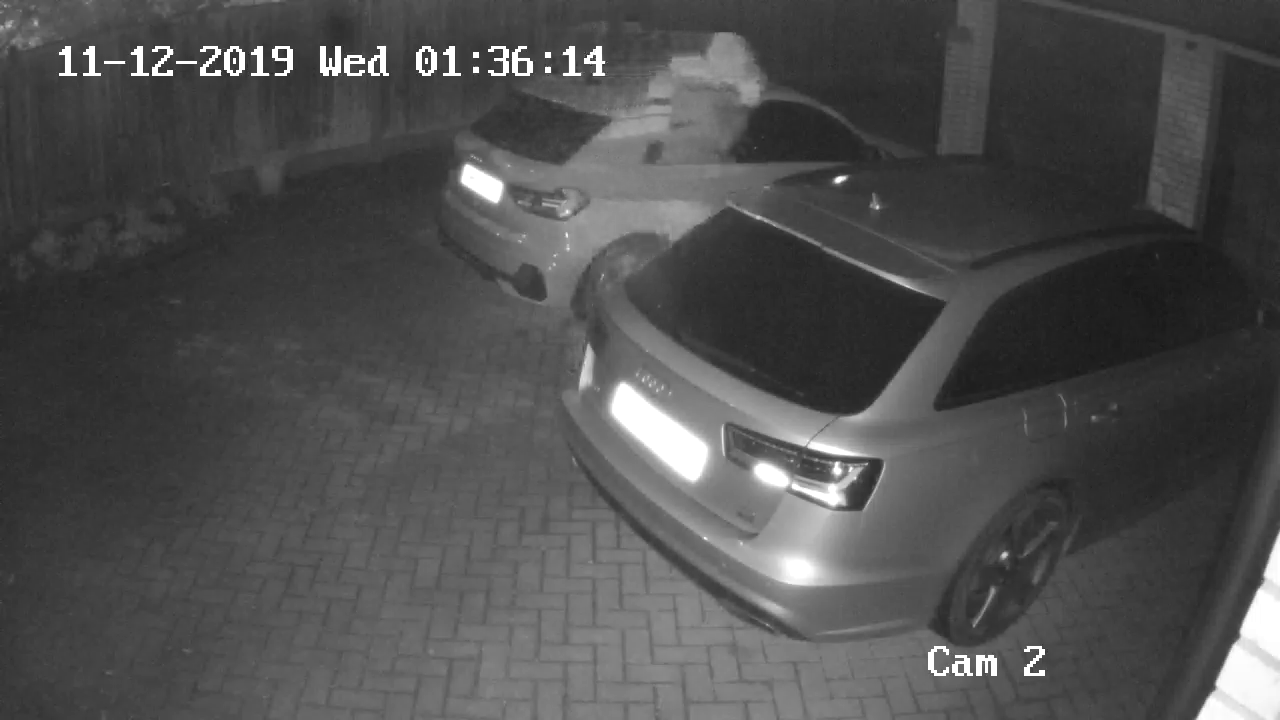

I have four cameras: DS-2CD2132, DS-2CD2142 and DS-2CD2163 x2 (all 4mm focal length) and I haven't been able to achieve decent night vision performance to allow adequate identification of unwelcome visitors (apart from the DC-2CD2132 installed at the front door). The picture is either too grainy or has ghost trails. Sometimes I can be hard-pressed to identify what they are wearing. Do you have any suggestions or do I need to consider changing the cameras. If so, what should I be looking at? (I'm not necessarily wedded to Hikvision).

Thanks Dan. I’ll persevere with my iterative adjustments. DNR & WDR are already on. There’s little pedestrian traffic so you will appreciate that this could take some time :-). Sadly the Hikvision Help files are less than helpful, simply stating the blindingly obvious (e.g. “Set the DNR level from 0 to 100”).

I have minidome and Cube cameras (DS-2CD2455 and DS-2CD2555) and I have exactly the same picture quality as you. I did try adjusting everything I possibly could (WDR, BLC, shutter speed, manual distance for IR light, frame rate, contrast, etc). You either get very dark image or too much ghosting / blurring to make any use for people identification or reg plates of passing cars. I don't think you can improve on that.
