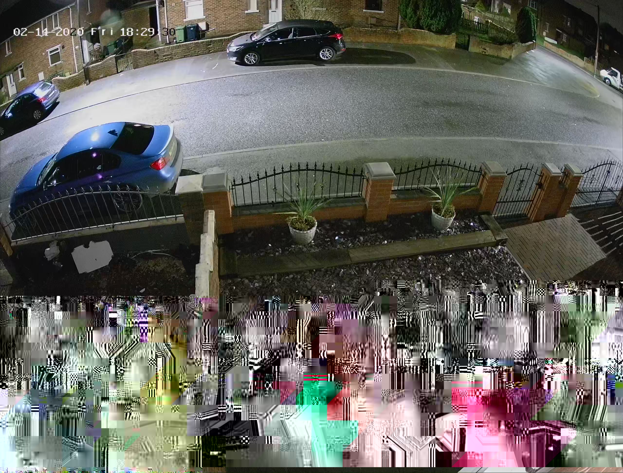

As a newbie,I have just had hikivision colorvu night vision cameras installed. I find when using the app to survail the cameras on my phone,I'm getting pixilation and colour blot on the video in hd.this doesnt happen on the monitor.my internet connection is excellent,and phone is ok with hd videos etc.in basic it's ok with a little bit of pixilation but very very little.just wondering if its their servers or me??

I guess this pixelization disappears and then appears randomly, right? Its' not static.
I have the same problem and it sometimes triggers false intrusion detection :(

I have been through all the firmware updates for the last 2 years and I'm on latest one. I get that pixelization on 2 out of 4 cameras (both outdoors) and they are all on the same (latest) firmware. Two other cameras (indoor) work well. Outdoors cameras are well protected (installed under overhanging ceiling) so there is no chance water could penetrate it. Only temperatures are more extreme compared with indoor cameras.
To me it more looks like the camera does not have enough resources to process the image and looses some data. Or maybe as you said - not enough bandwidth. But latter one is a bit unlikely as they all run on 1Gb cable. Or maybe not enough power.
The last thing I will try when it gets warmer is to re-do lan cabling (very sceptical this is the issue because I tested the cable from switch diagnostic tools and all 8 wires were tested correctly but I'm out of options)
I know of some other users reported the same issue. What helps is to change video settings (reduce i-frame). In the past (about 2 years ago) H264 seemed to be more stable than H265 or H265+ but after several firmware updates I'm not sure if that is still the case.

It's there all the time in hd mode
