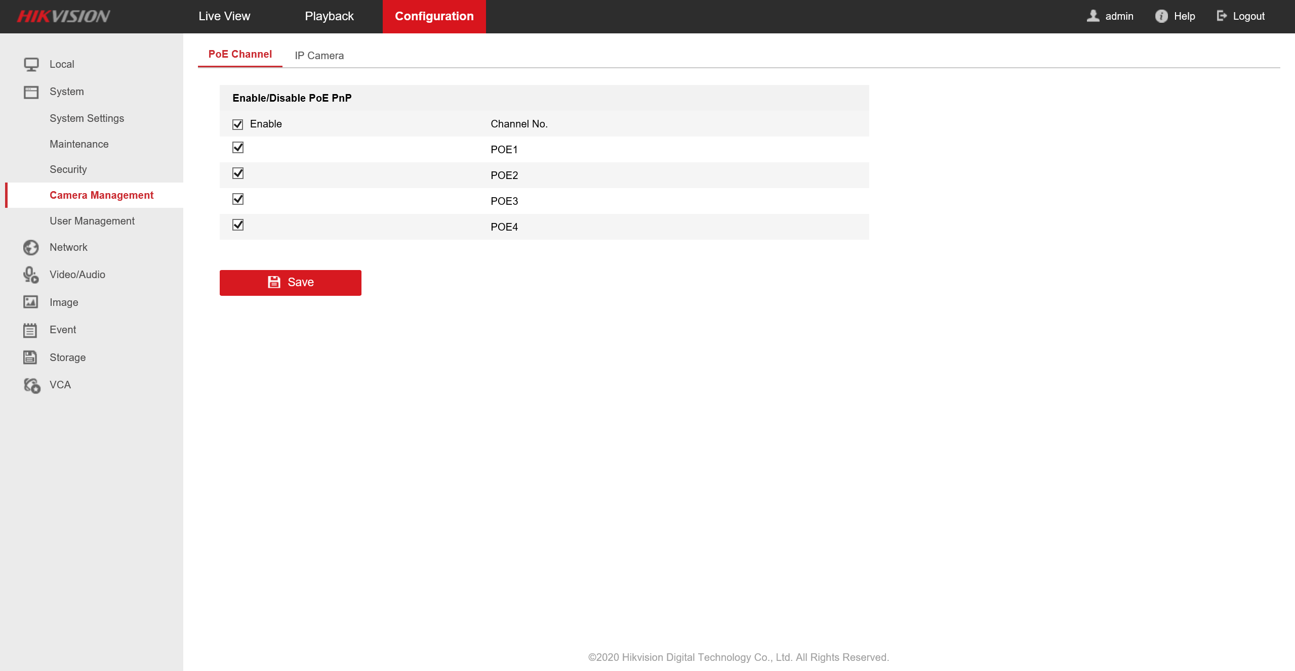

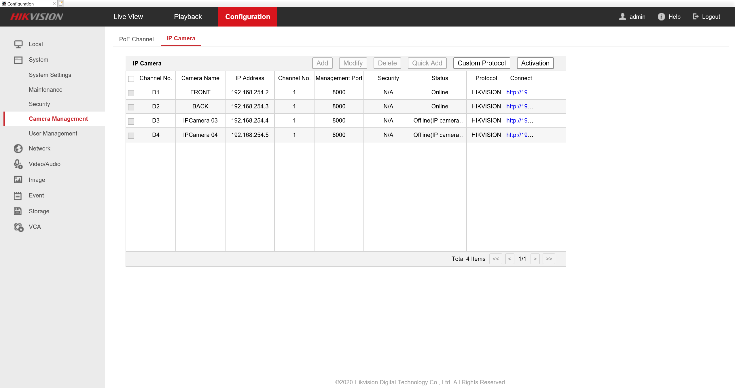

Can you please upload a screenshot of the Camera Management page from the NVR's Config?
Yes, Only 2 cameras both connected direct to NVR using POE.

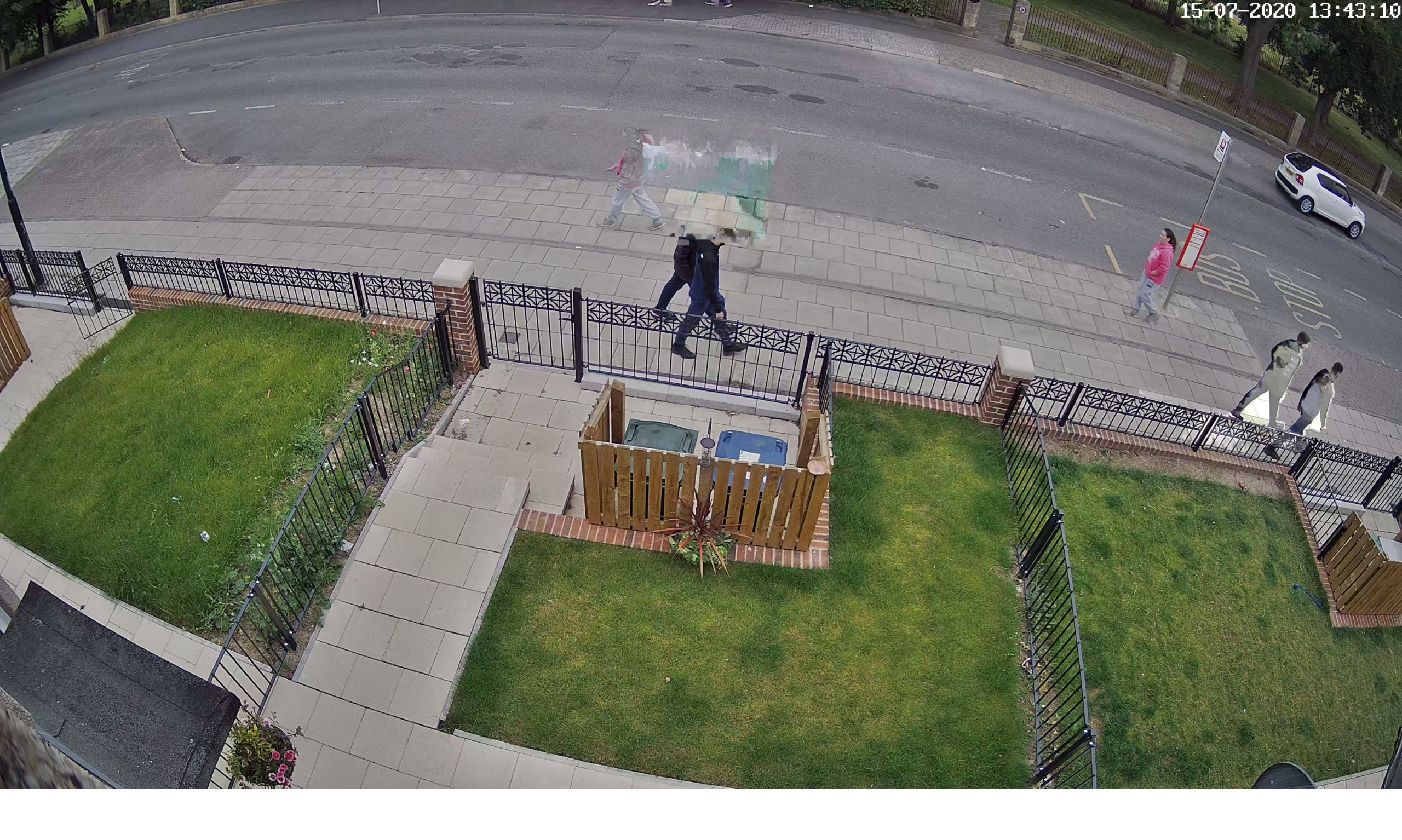

When the main stream is ok, i get what is displayed in the image.

Is that a LIVE view i.e. not playback and you get some sort of time shift effect?
e.g. the girl in the pink top, and the two lads, appear twice.
You are just watching the LIVE stream from the camera?
This happens when watching the live, main stream, from either camera, on the monitor connected to the NVR.
