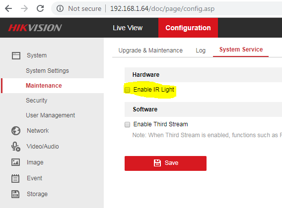

It doesn't look like the IPC-B640-Z has 'Smart IR'.
Somethings to try:
Try disable the IR light and see if it makes any difference.
Check the lens is clean.
Make sure you are on the latest firmware.
Keep us posted.

Thanks for the reply. I have researched on the net and i'm going to try speeding up the shutter speed ( thereby letting in less light ) to see if that reduces the washing out of the faces. I appreciate that everything else will go darker, but the main purpose of this camera is to capture faces. I'm also going to try it with Smart IR turned off (it does have this adjustment)

Hi flames, have you managed to resolve this issue i seem to be having the same problem, i have tried adjusting shutter and settings with no luck??
Hi silkpaint,
To a degree, yes. I've turned down the IR on the camera through the menus you access when logging in on a computer. I've also upped the shutter speed, to allow less light in. The downside of this is that the camera will not show anything else, so there is a very dark image, but with relatively better faces when people walk past the camera. I have another camera covering my vehicles, so that will capture the "action" and this one will help with the faces/number plates
