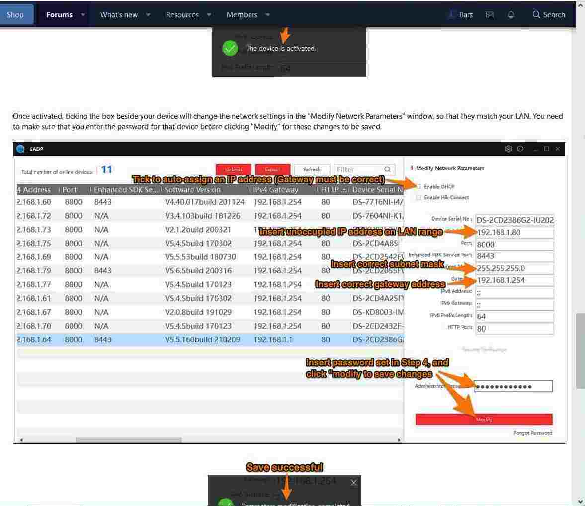

3. From https://www.use-ip.co.uk/forum/threads/part-3-how-do-i-find-my-hikvision-device-and-edit-its-network-settings.5917 / I don't understand the use of gateway 192.168.1.254. Do I have to perform this? (I don't use NVR). Att. pic.

3) In a simple home situation the gateway address is usually the IP address of your home internet router.
