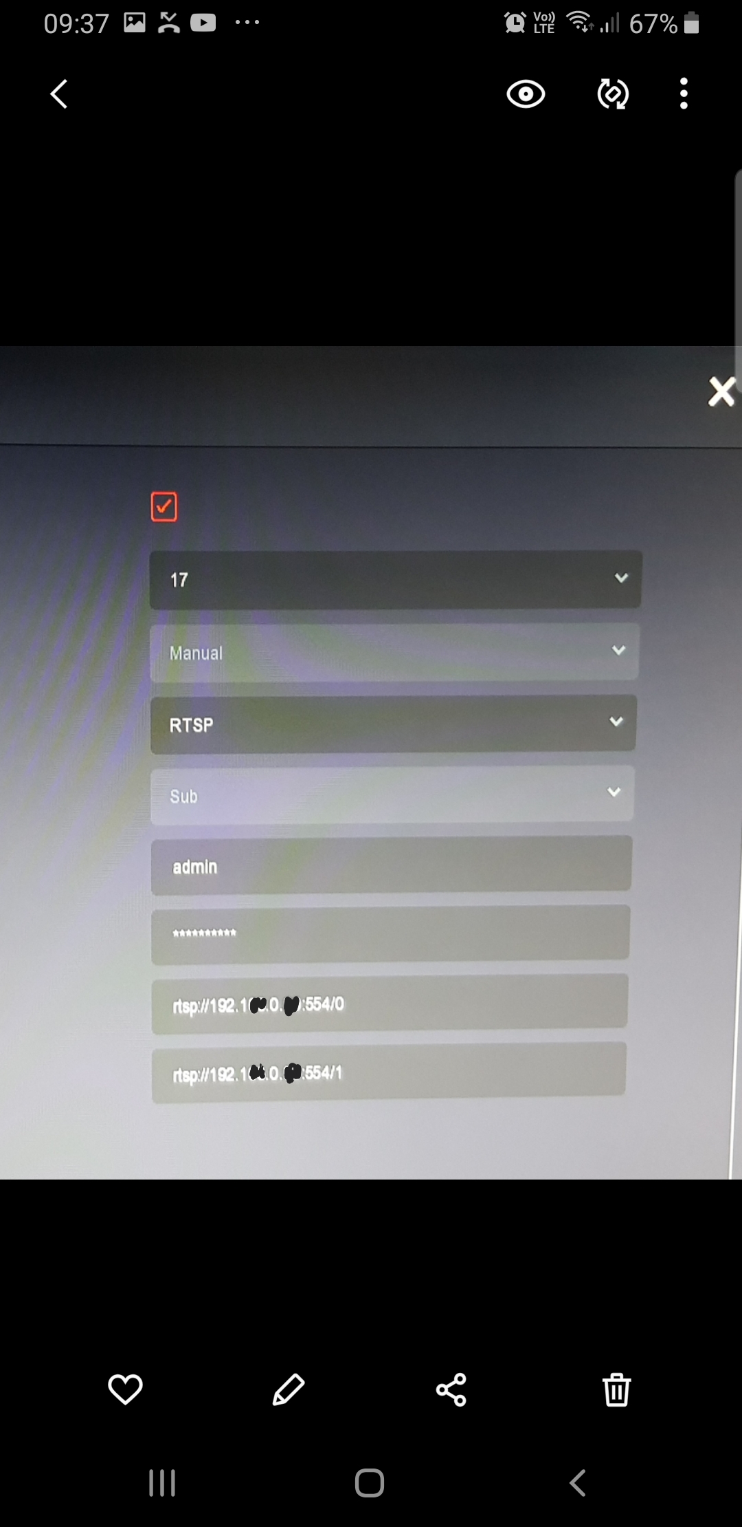

There should be different RTSP URL profiles that will let you pick the stream you want from the camera, I will find the ones I use and post them.The trouble i have is I have a ZXTECH XVR DVR but it will only see this camera on RSTP and not onvif. And i can't set it to full 4MP on the DVR so just wondering if i can get it to talk via onvif will i get the full 4mp. Have this camera on the bench and reluctant to fit if i can't get the full resolution. Camera is Hikvision DS-2CD2146G2-ISU AcuSense Darkfighter with latest update.

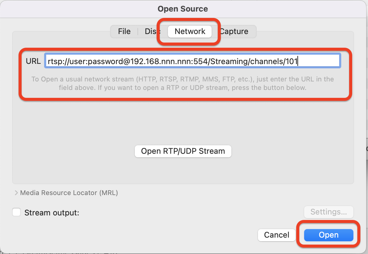

Can you play the camera mainstream (4MP) rtsp url using VLC?Hi David , I'm positive thats what my DVR is showing on the RTSP page. Do you know if this meams that it will be pulling the main stream at the highest resolution automatically even though in the camera configuration it is only set at 2MP and when i set to 4MP the image dissapears.
