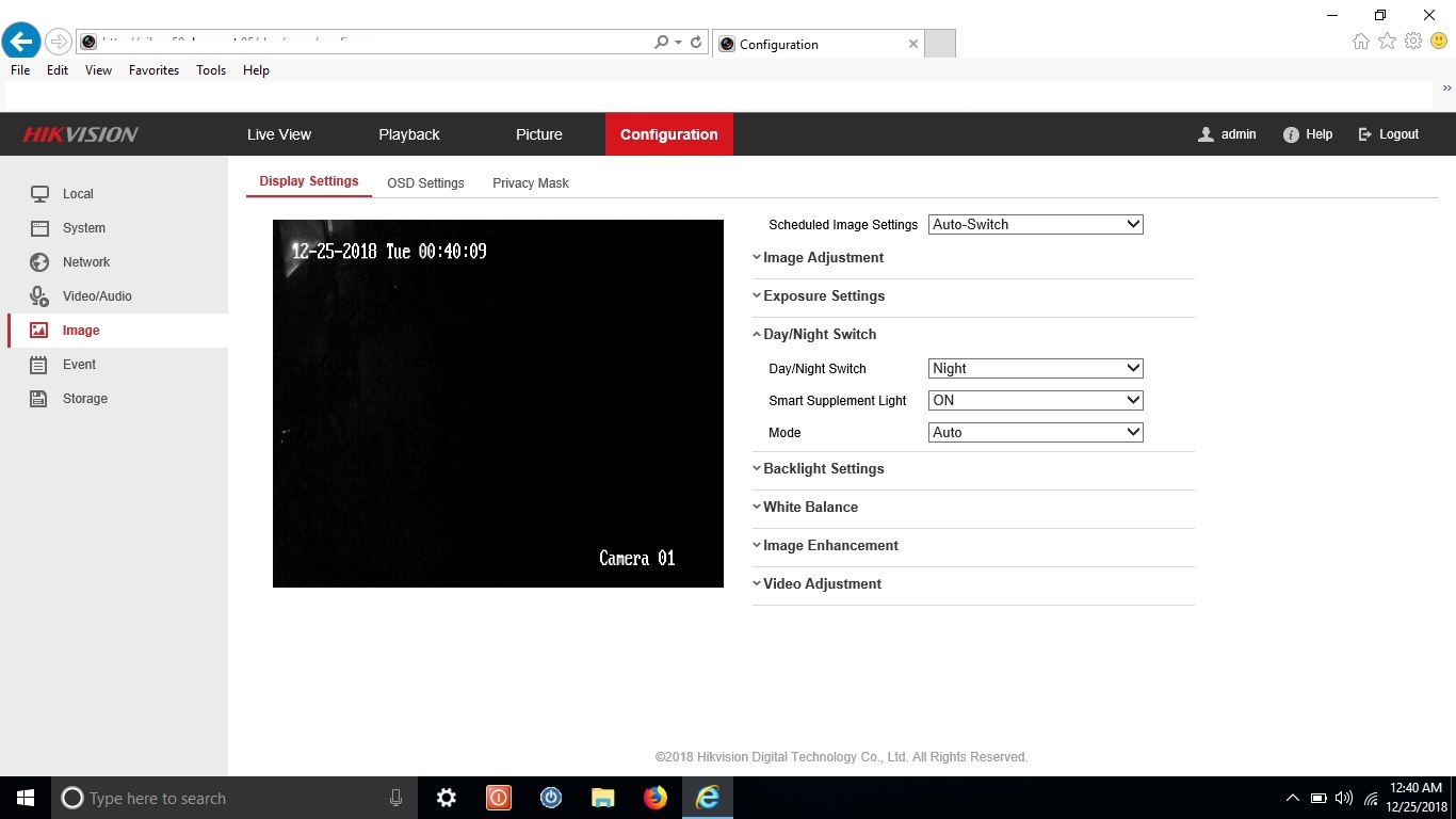

Test whether your camera's IR LEDs are actually still working - switch between day / night settings here:
(night should illuminate the IR LED's and force the camera into monochrome)
That light source in your scene will not help your eventual image.

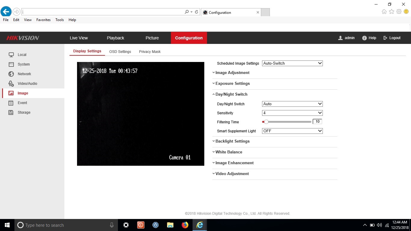

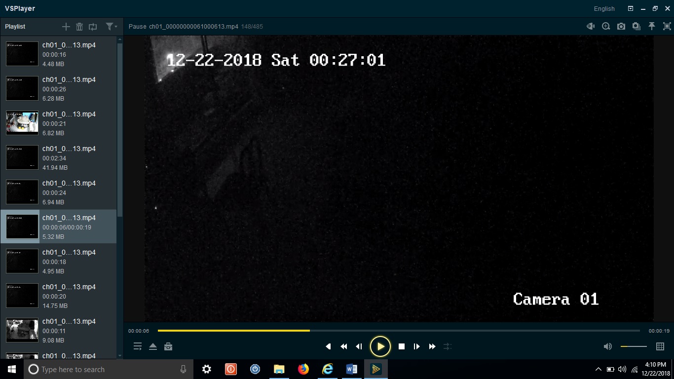

I tested to see if night vision is working with the above setting "Night" I select, after this I can see BLACK & WHITE Picture, but the problem I am having is that when there is very little light in the environment, the video that is being recorded or when I look at the live view, the picture is GRAINY and the video is filled with little dots and makes it hard to see the picture. How am I able to fix this problem?
And I already Re-Update the Latest Firmware by connecting ETHERNET Wire to my Laptop, still I am facing the same Problem as Picture is GRAINY.

From the images that you have posted it looks as if your IR LEDs are not illuminating - can you see them lit/glowing red when you select night mode?
If not, I can only assume that the IR LEDs have failed.
In which case you will need to return the camera to your supplier (assuming it is under warranty).
If it is out of warranty, it can be repaired, but it is often not cost-effective to pay for a repair (better to purchase a new camera / newer model / with a new full 3 year warranty).
