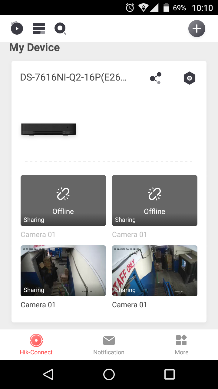

Hi all!
I have a new installation of NVR hik vision Ds-7616NI-Q2-16p. On my phone (Android) I can only view 4cameras out of 8 and only two are online the rest are offline. I have a total of 8cameras installed. What am I not getting right? Am using the hik application and attached is a screenshot from my phone?
Hi @Nthuli
What camera models do you have connected to the NVR?
Are they all directly connected to the NVR PoE ports?
How did you add the NVR to the Hik-Connect app? QR code, IP address, serial number?
Also, make sure your NVR is running the latest firmware - V4.30.000_build200508
The cameras are ds-2cd1123goe-I
All are directly connected to the nvr.
I used the QR code to add nvr to the app.
I tried to update show that this is the latest firmware. V3. 4.110 build 200212.
ok,
When you say you tried updating do you mean you clicked the 'check for firmware' button in the NVR menus or you actually tried loading the above firmware?
If you have just tried the button then the firmware will likely be out of date because that 'check for firmware' button has not been working on all the Hik NVRs for a long time now, I would recommend downloading the above v4.30.000 firmware and try updating to that.
If you are unsure on how to update Hikvision firmware then you can use this forum guide:
If after the update you are still having issues with the app we would recommend you delete the NVR from the app, open the SADP Tool and unbind the NVR from your Hik-Connect account, and then try adding it again using the serial number in the Hik-Connect online portal.
You can find the steps for doing this in this forum post:
Hi Dan.
Thanks a bunch. it worked very well.
