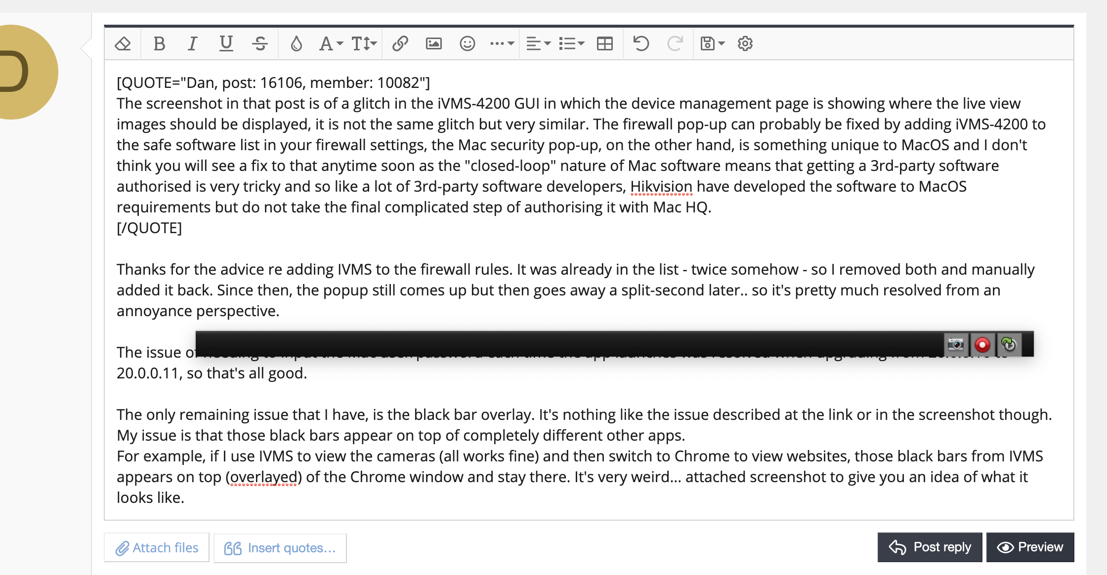

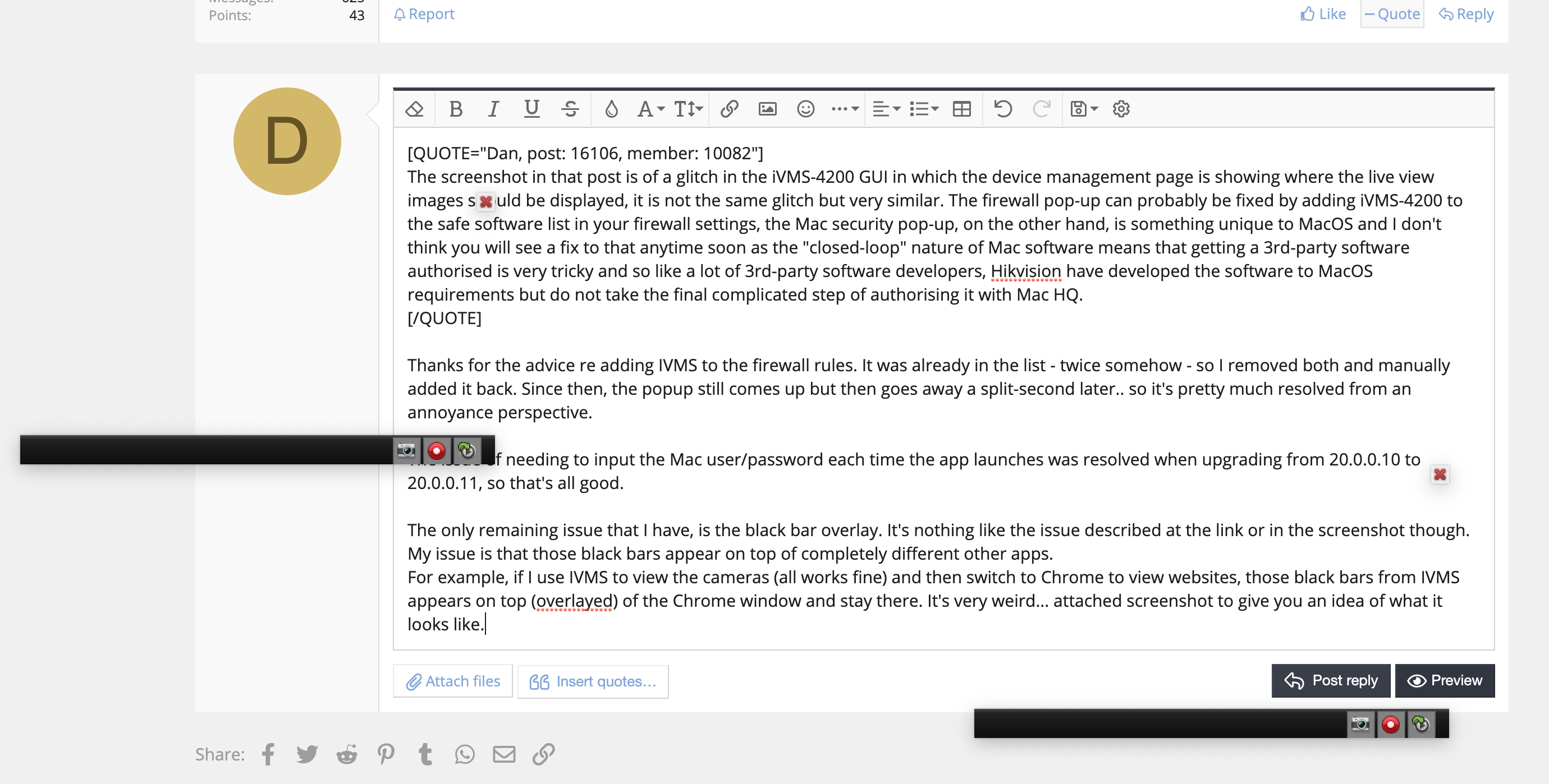

The only remaining issue that I have, is the black bar overlay. It's nothing like the issue described at the link or in the screenshot though. My issue is that those black bars appear on top of completely different other apps.
For example, if I use IVMS to view the cameras (all works fine) and then switch (CMD+Tab) to Chrome to view websites, those black bars from IVMS appears on top (overlayed) of the Chrome window and stay there. It's very weird... attached screenshot to give you an idea of what it looks like. I alt-tab'd from IVMS to Chrome to reproduce the issue.
