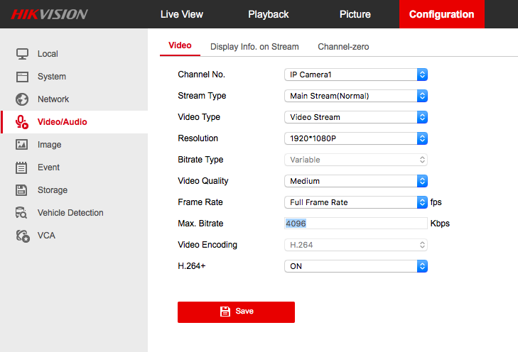

Just take a look at your bandwith, to see where the bottleneck is. The streamsettings are adjustable on the NVR directly or on the client, you can switch mainstream/substream, like @RWB already mentioned.
In the webinterface look at the screenshot, they look similar on the NVR... You need to search a bit in the menu ;);)
