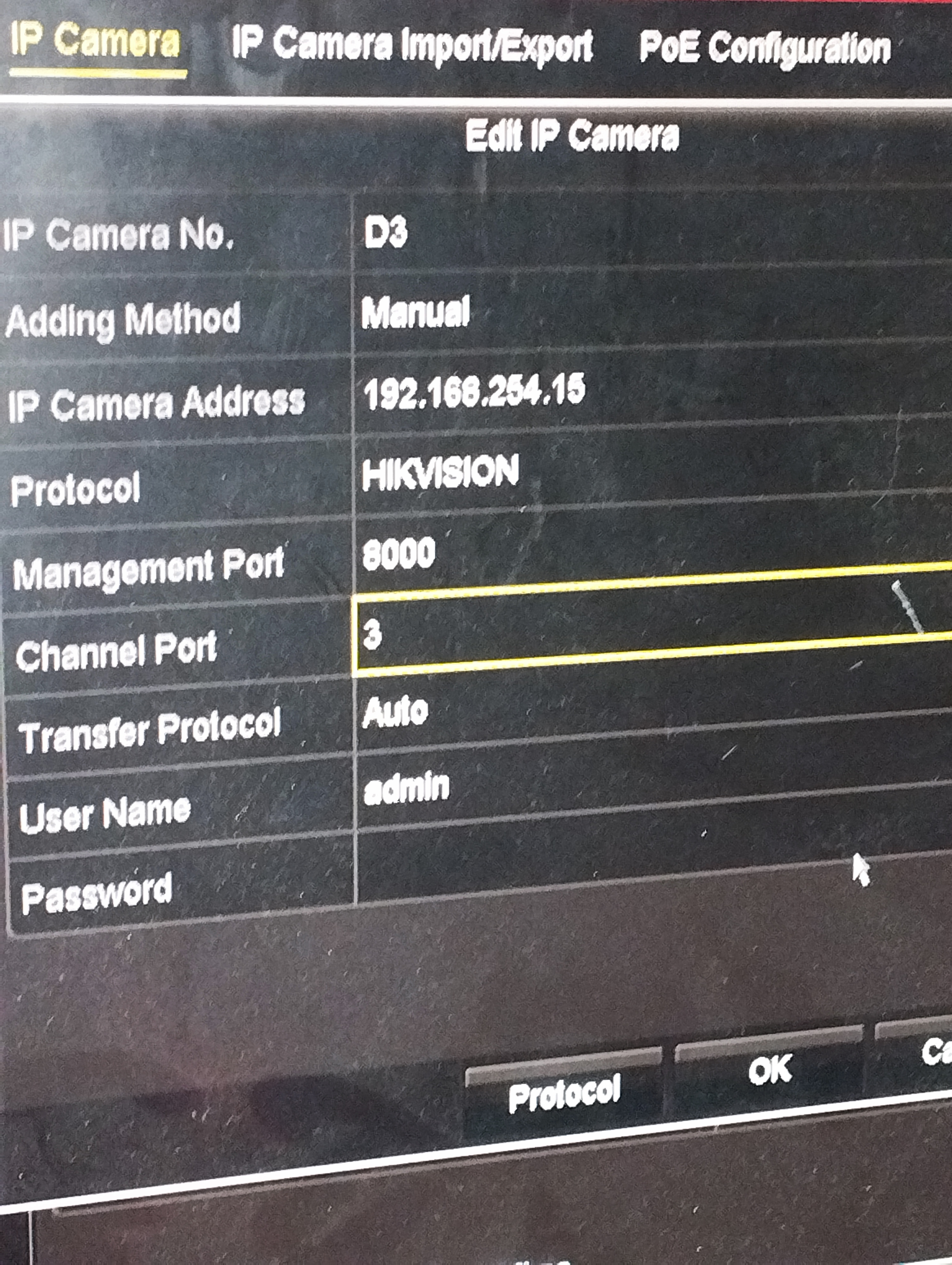

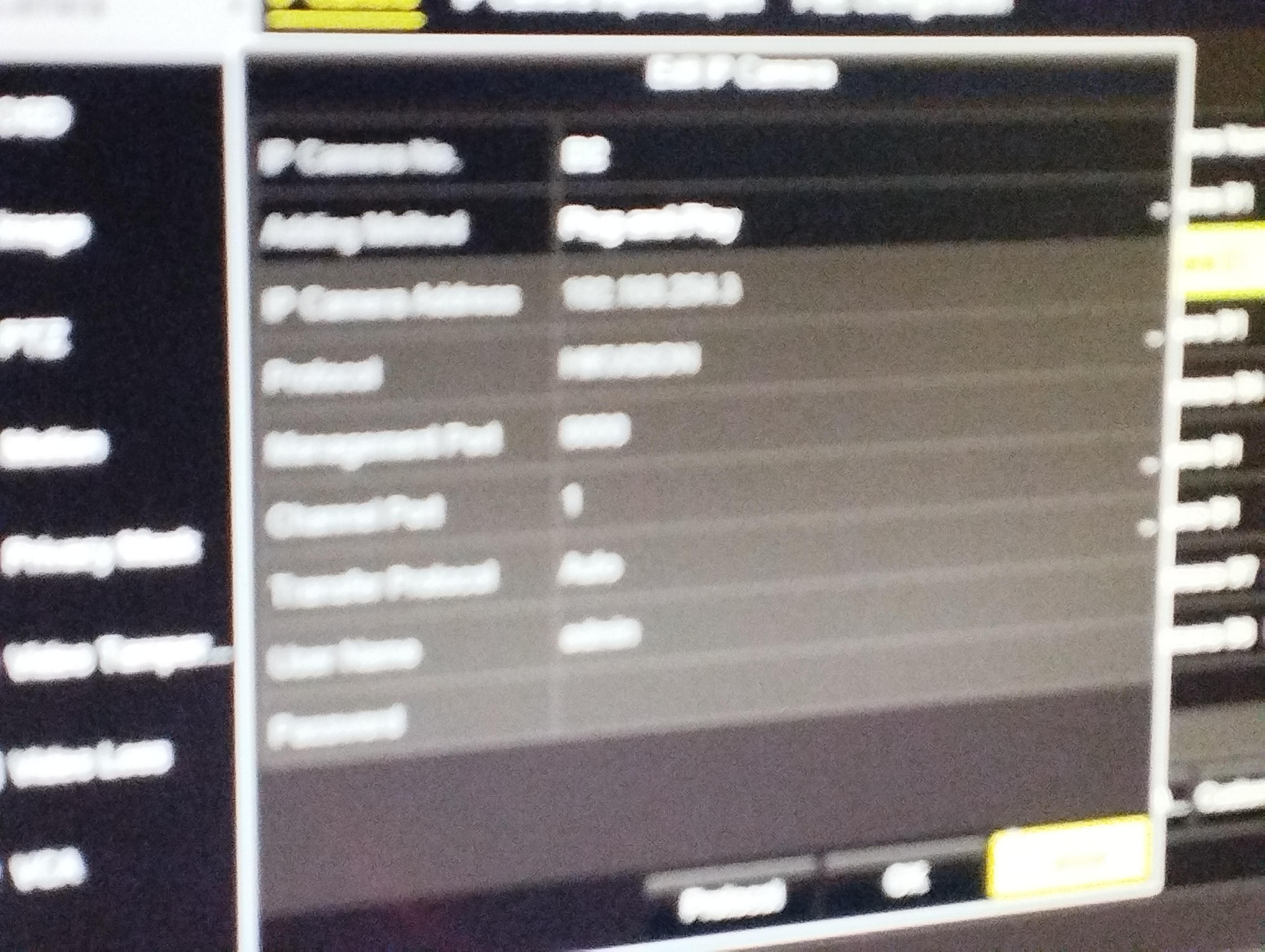

I noticed that all were set to plug and play and all on channel 1, so i clicked on manual, changed the channel to match the port number (e.g channel one matches port one the camera is plugged into on the dvr, etc), then back to auto, and it still keeps doing the searching and nothing shows on live view. help! The cameras I have connected are:

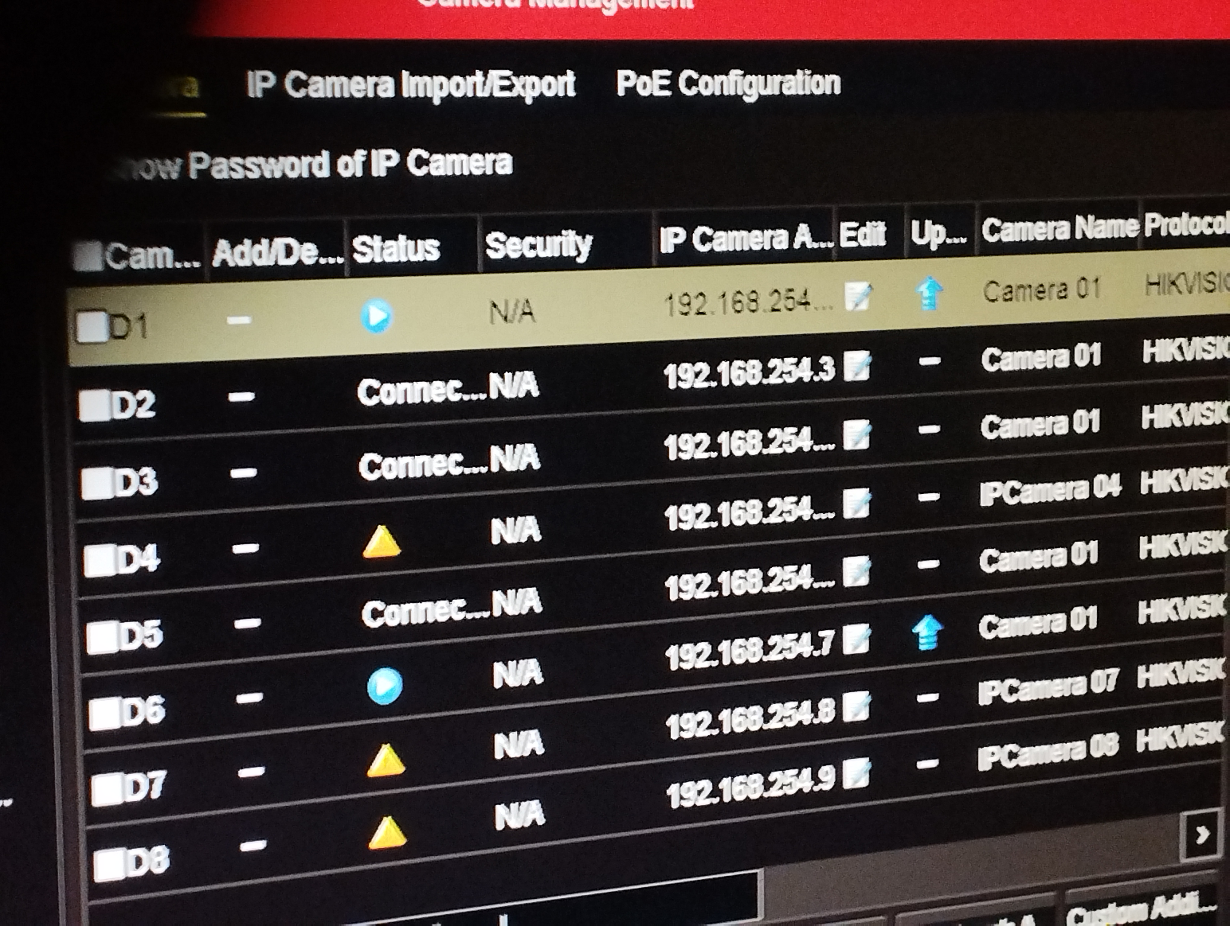

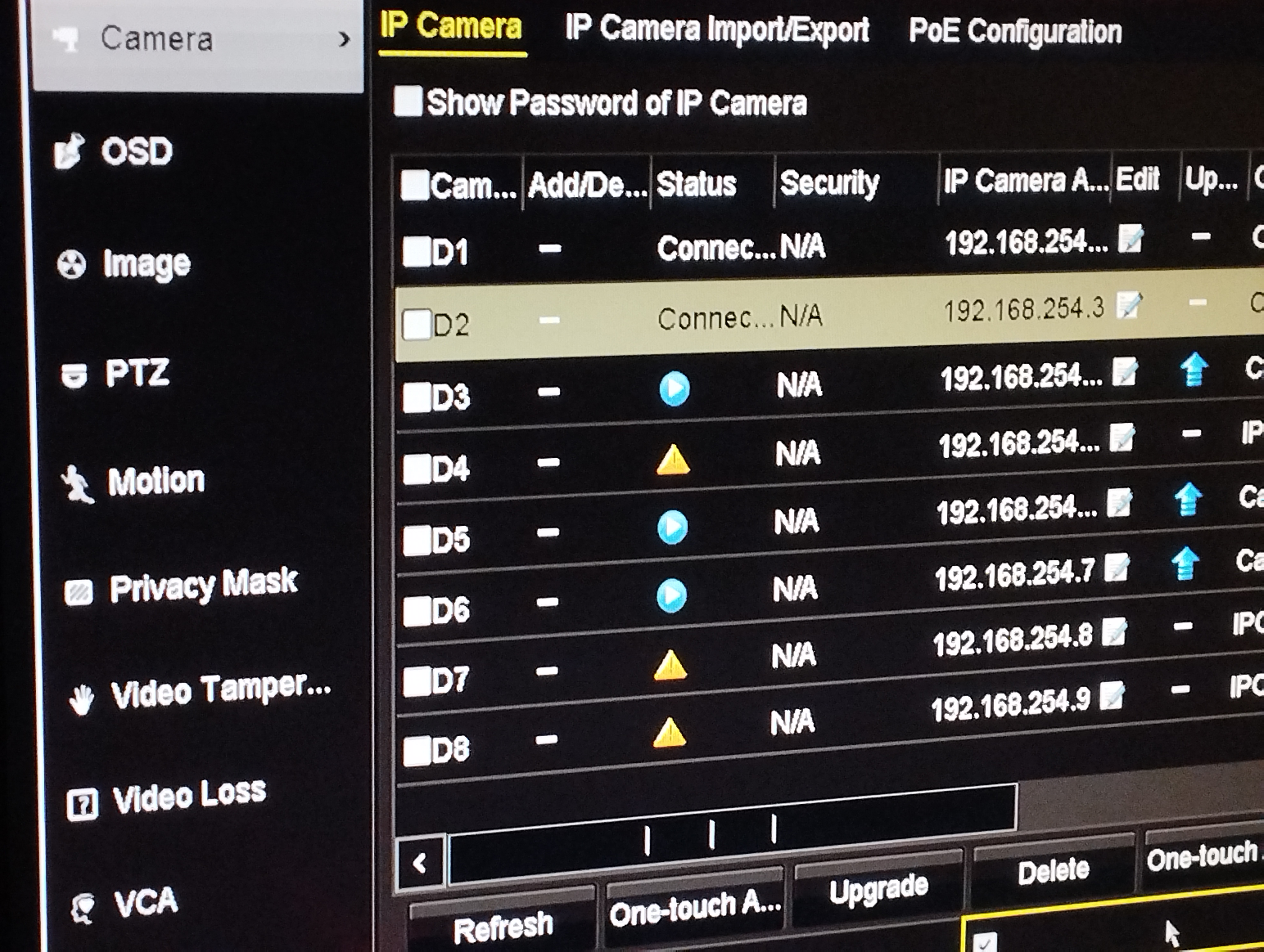

If I go to add IP cam and refresh I see them all appear one by one then disconnect one by one

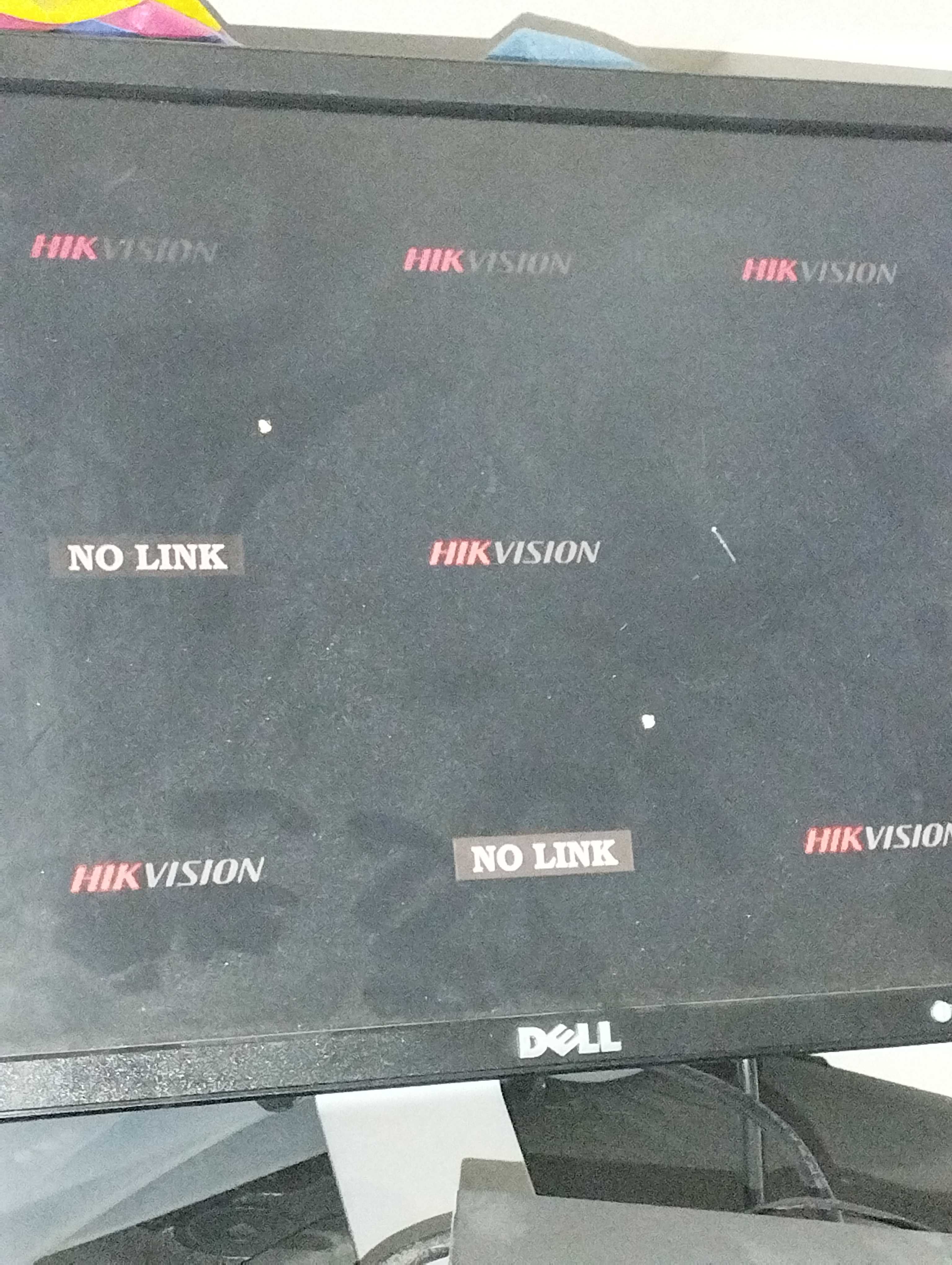

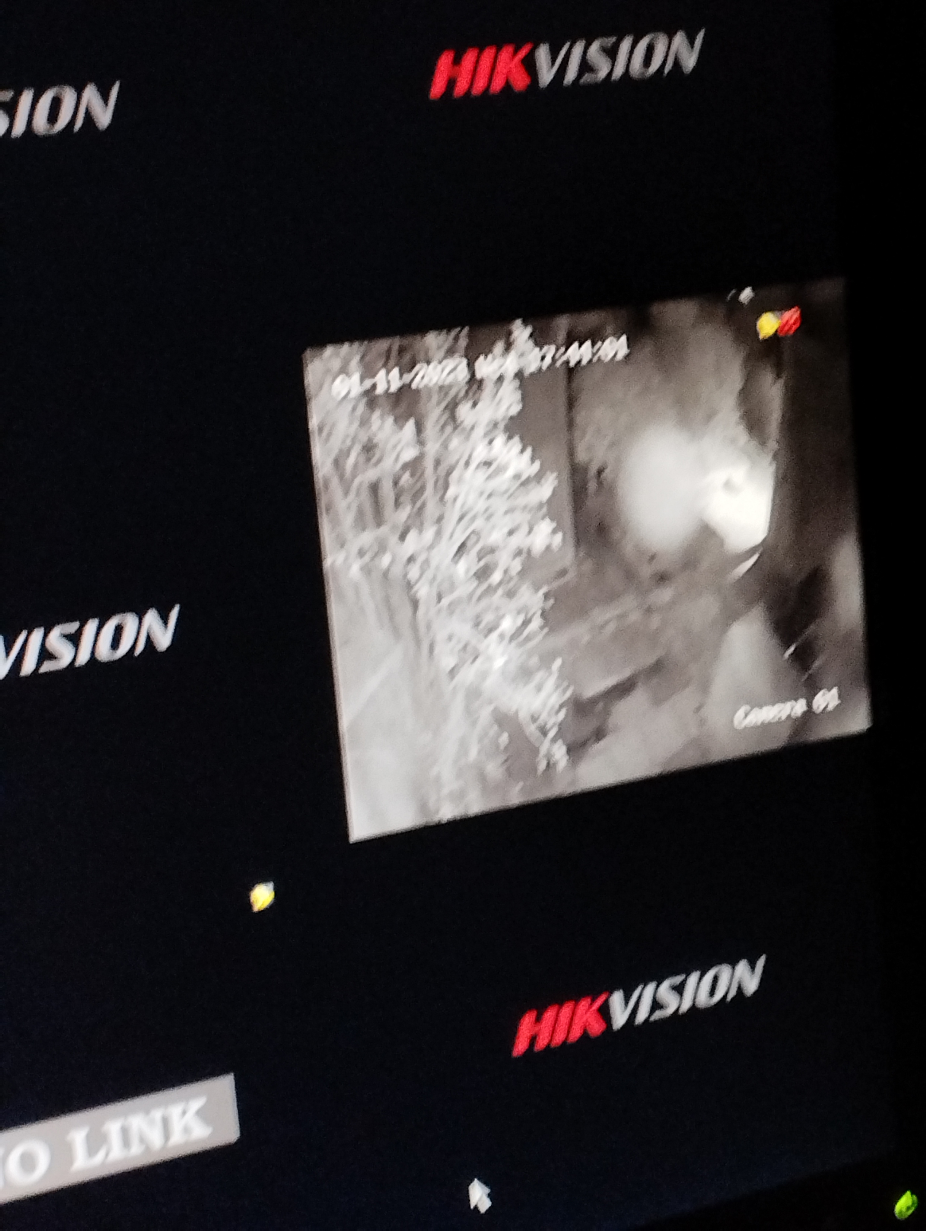

Hi all cameras were working fine until I did the firmware update.
If I leave the unit for around ten minutes the camera will cycle through cam 1 being on the monitor, then the camera will actually disconnect in the IP camera page, then cam 2 will come on and do the same, cycling through each camera. At no point will they all stay on at the same time.
So the cameras all work, and they do come up on the monitor but on the page that says "add IP cam" you have the list of cameras, with only one at a time saying connected, then it disconnects, says searching and the next cam comes online.

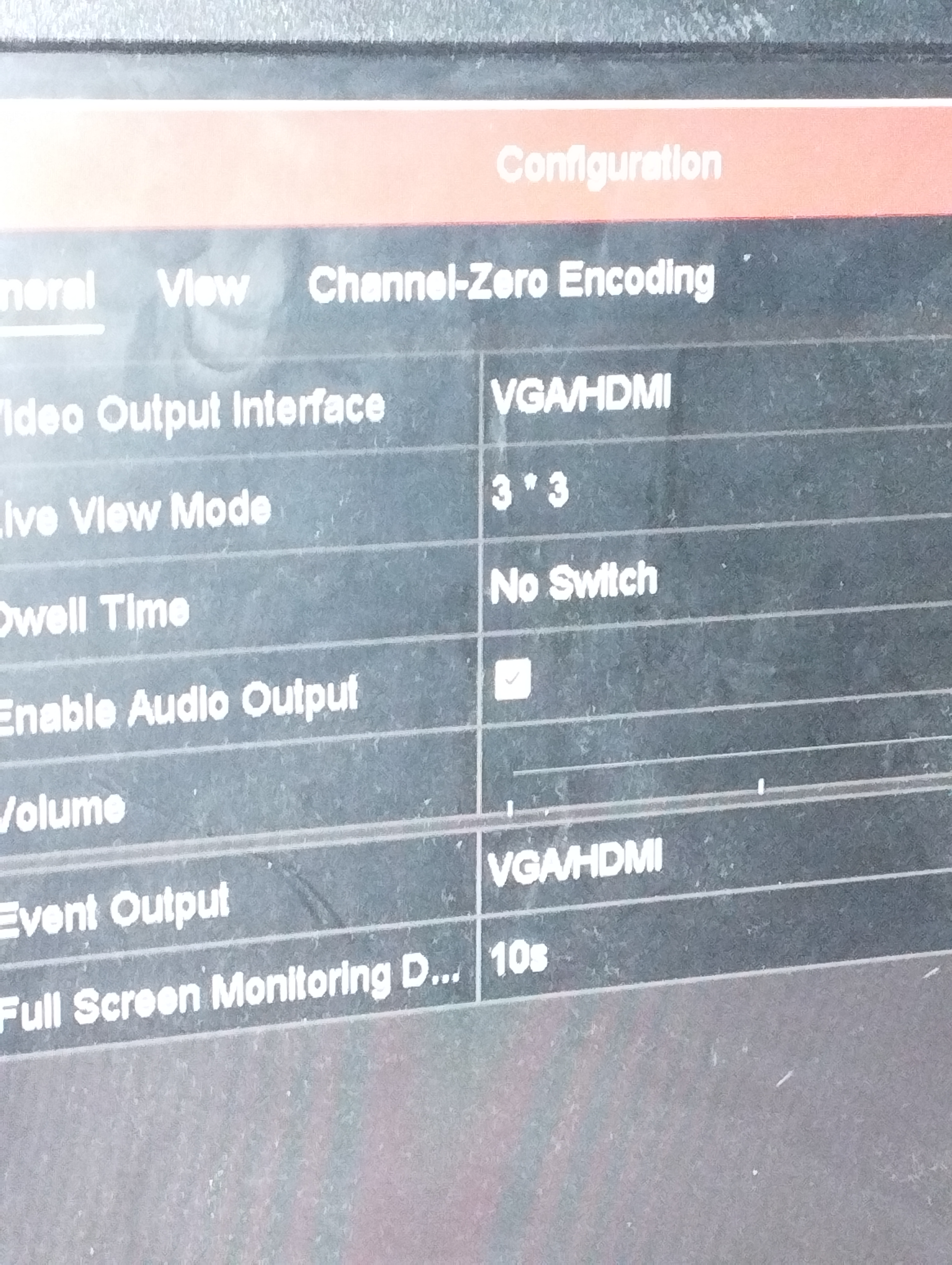

Screenshots or photos of your direct monitor UI would be really helpful for us trying to diagnose what is going on with your system.
Screenshots attached

Hi @dodefyvie
I can't understand what is causing this, as far as I am aware we have never seen NVR behaviour like this before.
I think the only option will be to hard reset the NVR and try setting it up from scratch again with the same password as before (hopefully that way the NVR should still have the same password that was used to activate the cameras before).
If you still run into issues after resetting the NVR then you will have to hard reset the cameras as well.

I don't have an answer to your issue but just want to mention that the channel number refers to the camera and not the port on the nvr. In your case they should all be channel 1. The channels are used when multiple feeds are returned from one ip device, such as a panovu camera or an encoder. These devices would return multiple camera feeds to one channel on a single IP address and the channel number is used to identify each feed.
