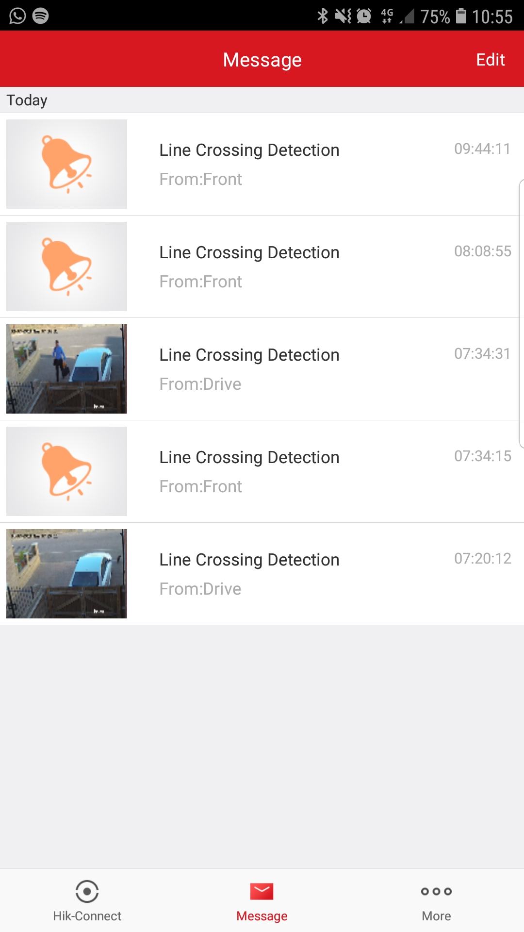

Does anyone know why I am only receiving images on email notifications or under the message tab on HIK Connect for 1 of 3 cameras on my system?
I have line detection set up on all 3, which works fine as I get the emails/app notifications but only see images for CAM1. The emails for the other 2 cams have no attachments, and the app just displays an orange bell instead of a snapshot of the detection. Confused as firmware version is the same for 2 cameras that are behaving differently...

So I changed the digest settings for all cameras but it made no difference. Image attached for reference, any ideas anyone?
