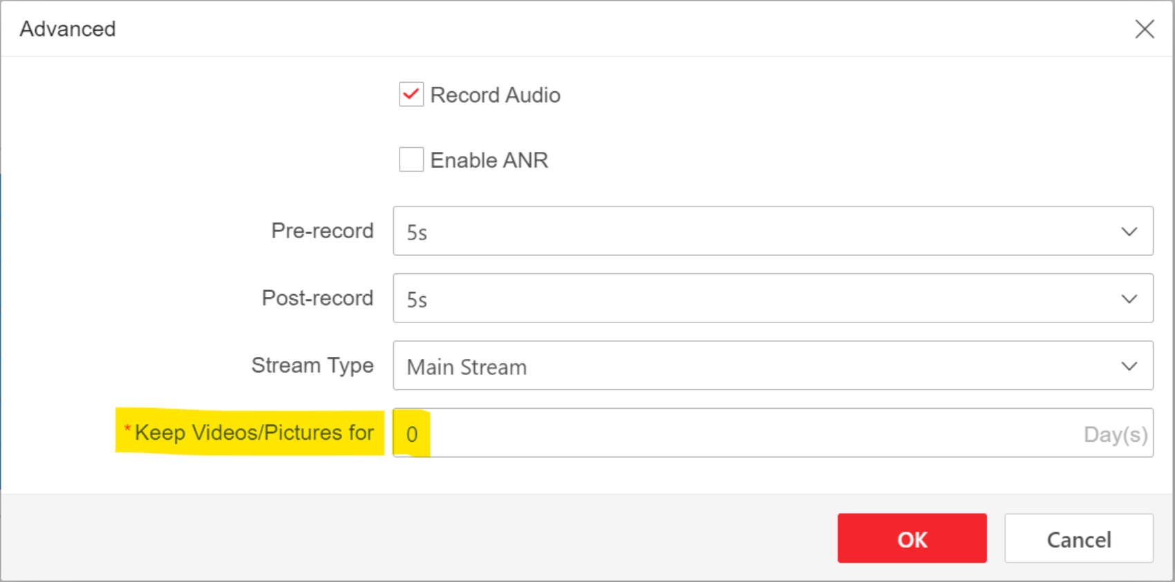

Hi @John A
You'll need to set the "Keep Videos/Pictures for" field in your Advanced Recording Schedule settings to "0" for the NVR to overwrite the oldest footage when the hard drives fill up:
It's worth running the S.M.A.R.T and Bad Sector Detection hard drive tests in Storage>Schedule Settings>Advanced in a web browser to verify if these are the problem.
