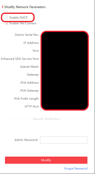

Toggling DHCP in SADP is useful for finding an open IP address on your network as it saves you going through all the IPs that are in use to identify the ones that aren't. So you can tick the box for "Enable DHCP" in the device's network parameters to assign it to an open IP, and then untick the box again. This will keep the device assigned to this open, and now static, IP.
The DHCP tick box in SADP is shown below:
