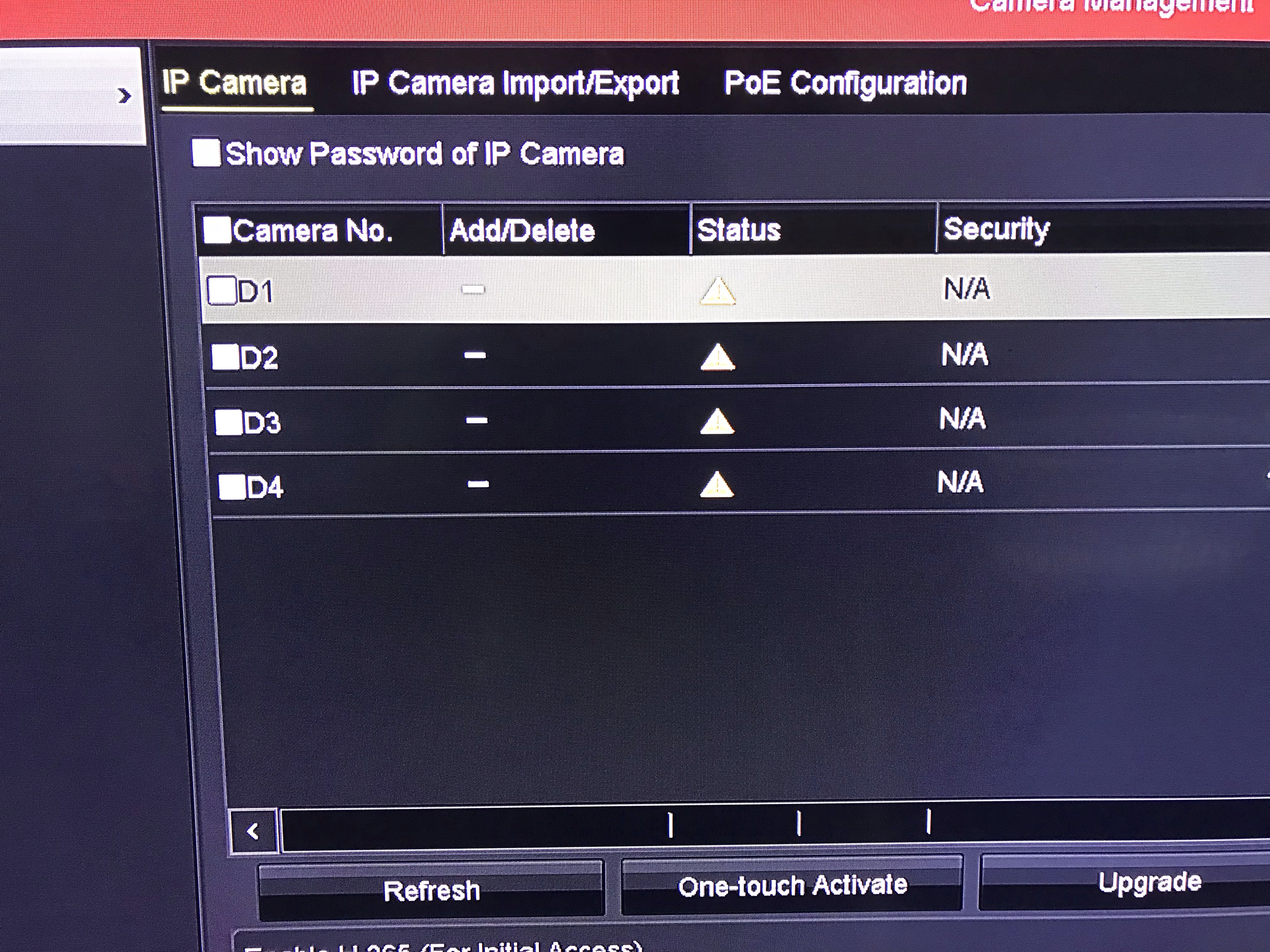

Hi Guys, Thanks, done just what the doctors ordered, firmware successfully upgraded to V3.4.103 but still showing "No Link". On the rear of the NVR all camera ports appear to have activity as both the green and yellow lights flicker. When I click on camera in menu then remove the camera cables from the ports, re-instate them it show "detecting" then nothing. There's the yellow triangular symbol in the Status column.
Any help is appreciated.
