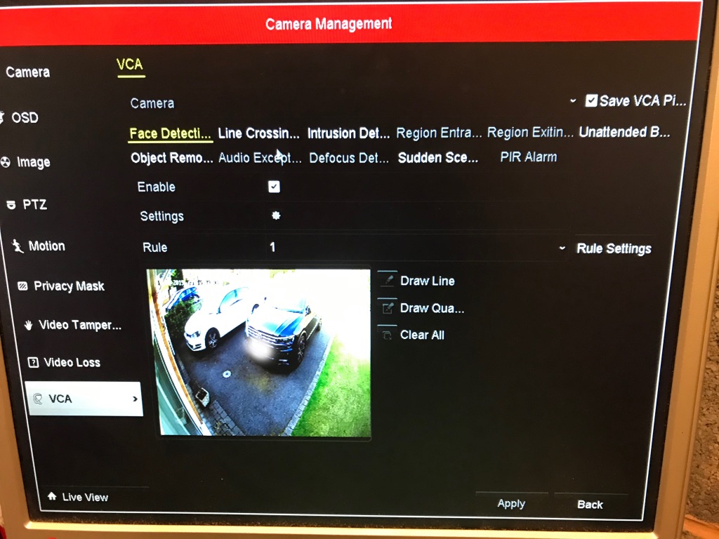

I have a DS-7604NI-K1/4P NVR and a DS-2CD2345FWD cam. I do not get notification or any acknowledgement for face detection and VCA says no device available. I get motion detection ok.

Try this:

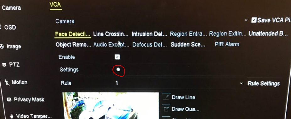

Click the cog (image below). Check your Arming Schedule is set to all-day every-day. Then under Linkage Action, check Audible Warning to make it easier to confirm it's working.
Next check Menu>Configuration>Exceptions. Make sure Enable Event Hint is ticked. Click the cog next to Event Hint Settings and make sure Face Detection is ticked.
2642
Hi, just tried what you suggested and everything was already set as you suggested. Thanks for your help

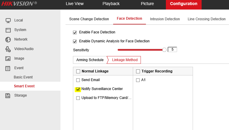

In your camera settings, under Configuration>Smart Event>Face Detection check Notify Surveillance Center is ticked. For testing it's best to look straight at the camera from less than a couple meters away for the alert to trigger reliably.
2643
Yup, thats already done but I have noticed my sensitivity is only on 4, so I have upped it to 5 and will test it tomorrow, thank you for your trouble
