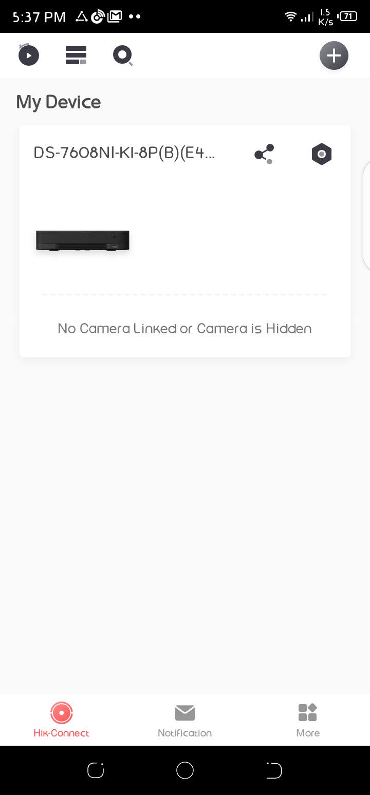

I just recently installed a ds-7608ni-k1/8p(b) with firmware V3.4.110 build 200212. When I set up the Hik-connect app it says "No Camera linked or camera is hidden". I have tried using a poe switch and also connecting the cameras to the poe ports on the nvr.
I have attached a screenshot.
Any ideas on how to fix this?

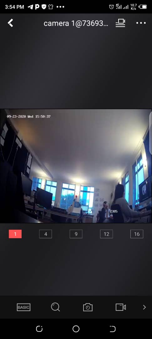

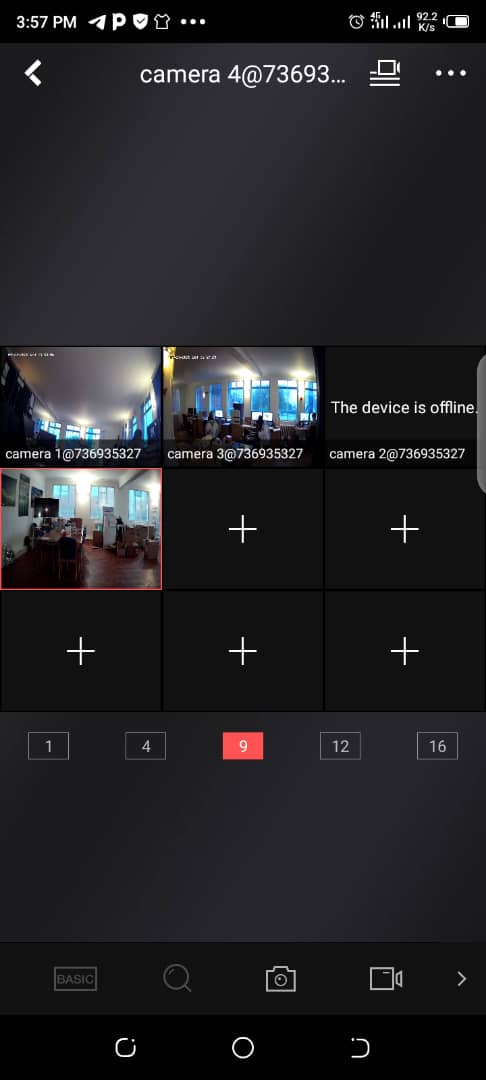

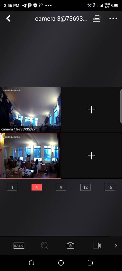

I was able to connect and view.
I have attached snapshots.
OK - that proves it's not the phone nor the App.

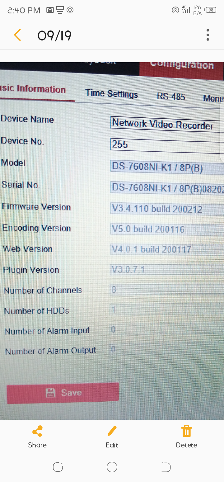

The NVR is running version V3.4.110 build 200212 and the cameras are running version V5.5.94 build 190902

There is a 3.4.112 firmware version for your NVR here:
DOWNLOAD EU PORTAL
I would try just that first.
The V4 firmware at that page would be a major step-change - it brings a completely new user interface.

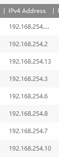

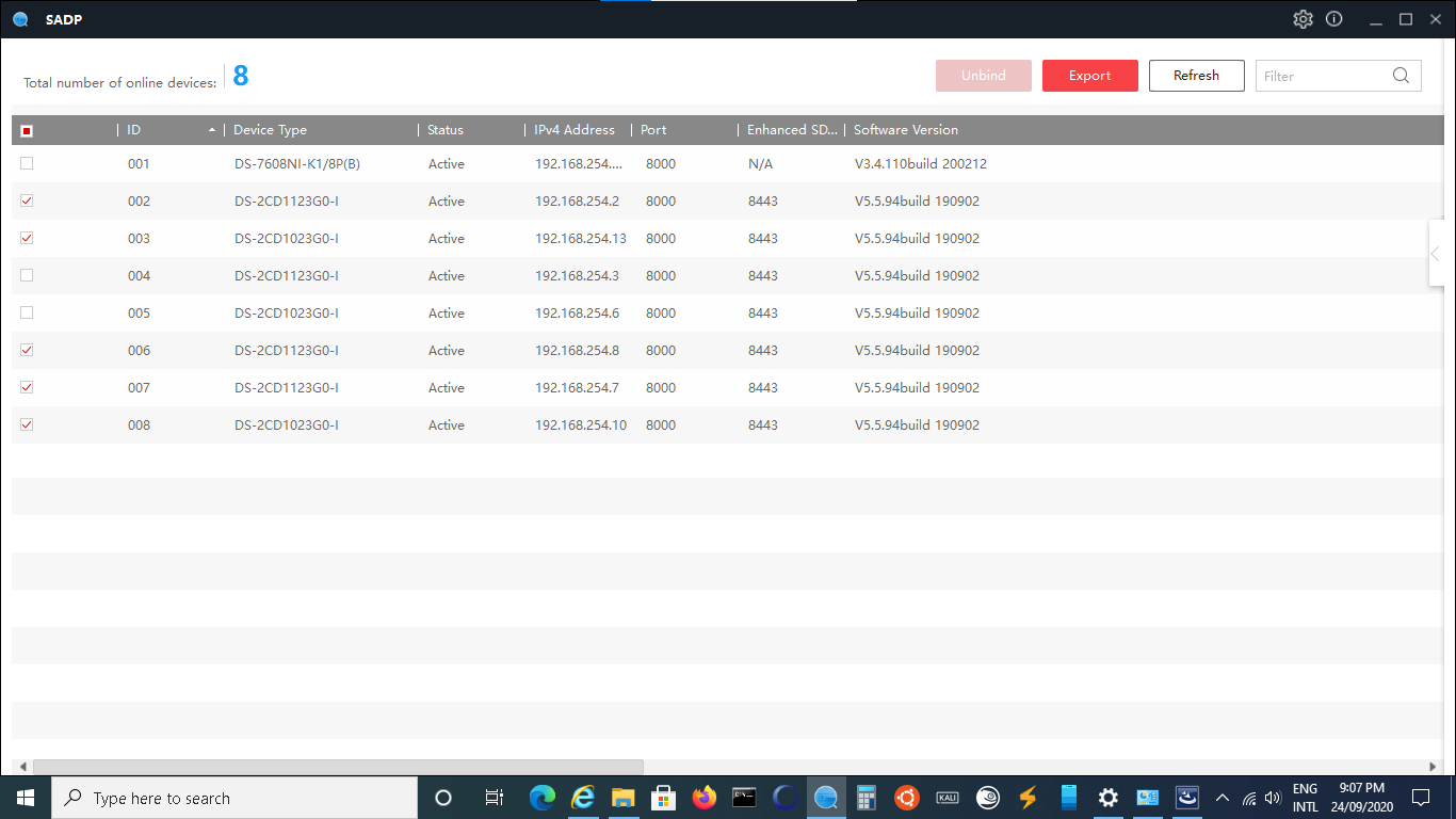

BTW I just noticed an anomaly with your IP addresses.
I can't quite see the full IP address of your NVR, but it looks as if it is in the same domain range as your cameras?
Are all of your cameras directly plugged into the POE ports on the back of the NVR?
If so, then normally they would not show in SADP, only the NVR would show on the LAN (assuming that you were running SADP on a PC at another IP address on the same LAN).
I had to connect all the devices to a poe switch so that I could screenshot to send to you. I changed everything back to the poe ports on the nvr and changed the Ip addresses after the screenshot.
Will do the firmware upgrade on the NVR and hope it resolves the issue.
Will update the thread when done.
Thank you so far.
What does SADP show in your normal configuration?
I would expect it to show only your NVR.
I would not expect your NVR's IP address to be in the range 192.168.254.XXX (as it was, top of the list in post #18)
