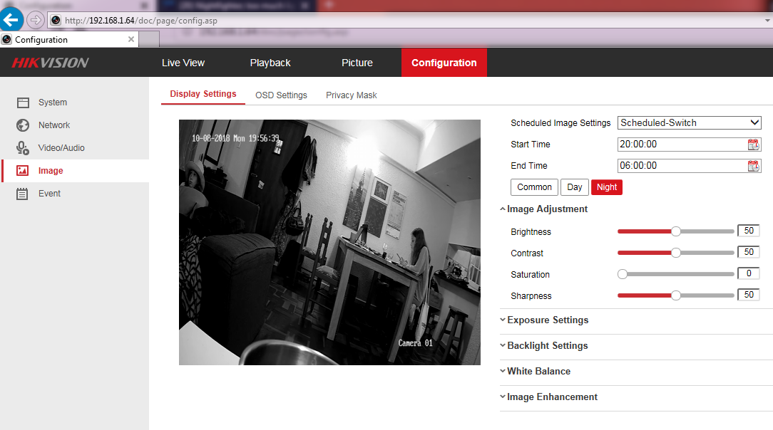

Maybe a scheduled night switch with 0 saturation, then day switch with normal 50% saturation?
