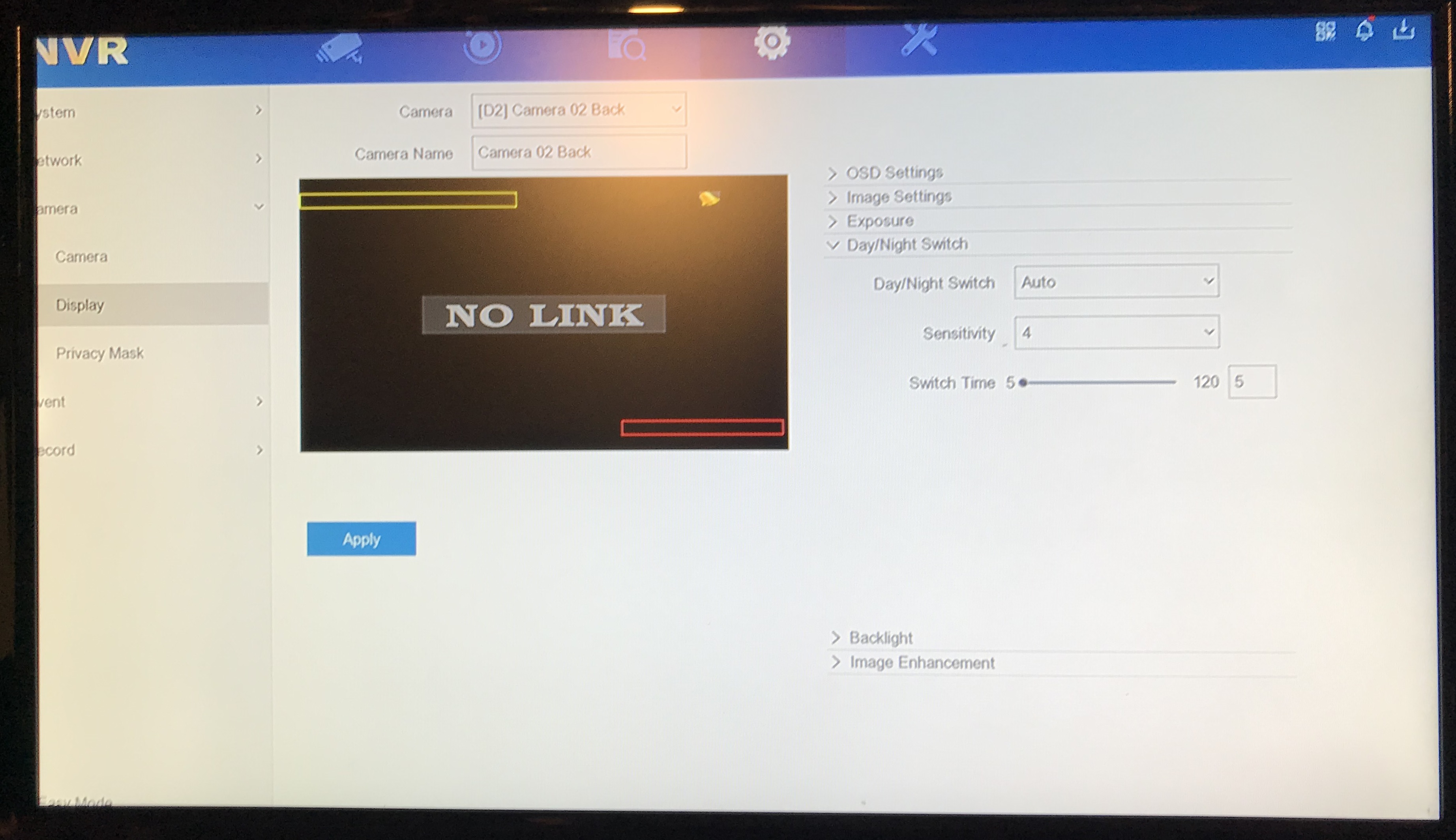

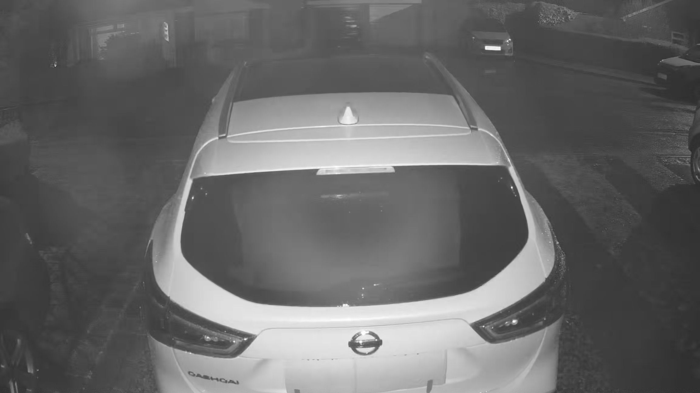

Hi, I have a Hikvision Hilook IPC-D150 (H-M) camera connected to a Hikvision NVR 104, I am trying to turn the Infrared light off because I am getting a lot of glare off my car because it is close to the camera, I have gone direct into the NVR but can only find a Day/Night control, does this disable the Infrared Light? There is plenty of street lighting so I don't NVR 1.jpgCamera 1.jpg think light will be a problem, I have attached a pictures of Day/Night in the Configuration of the NVR and the problem
Yes - try it?
See what options it offers.
With that kit you may be limited to day = colour = no IR as your only option?
I have the same NVR and cameras.
The 'Day/Night Switch' sets the selected camera to day, night or auto switch mode according to the surrounding illumination
