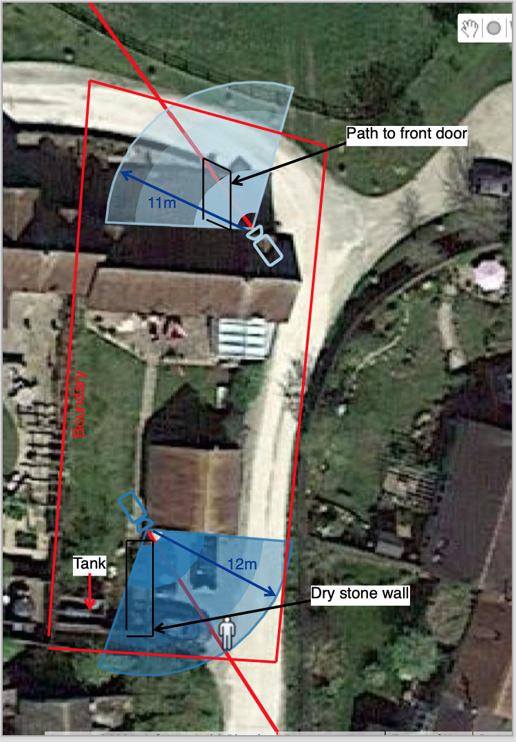

I am looking to replace my cheap and cheerful cameras with some that actually work and noted this discussion was broadly what I was after. I just wanted to be sure this would work in the plan attached.
The camera at the front would be North facing about 2.2m high, 2m from the door and on a soffit about 1m out from the wall. I would need good resolution out to about 11m to cover the whole front garden, and the two way audio to remotely talk to people at the door.
The rear camera would be South facing, 2.5m high and directly above the garden gate. Covering the garage and driveway and access to the oil tank, again good resolution to 11 or 12m, and the two way talk would be good for deliveries.

This is what the image would include at the rear, my only concern is the proximity of the walls and tre IR reflection.

Your suggested positions look good, though :) It looks like you have selected a 2.8mmn focal length in the attached plans, which will cause you to lose clarity in your image beyond 5(ish) metres. These do give a wide coverage which seems to suit your needs, though, so I would be inclined to consider the higher resolution model to help with this loss of detail at the spaces further from the cameras.
For this rear camera, you're right in that the walls will cause issues with IR reflection and cause overexposure. You want to keep as much of these out of the shot as possible, so the camera would benefit from being mounted higher (if possible) and perhaps also from a 4mm lens - but there will be a bit of a blind spot right in front of the camera if you mount at this height with a 4mm lens:
