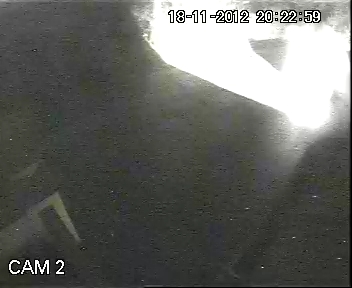

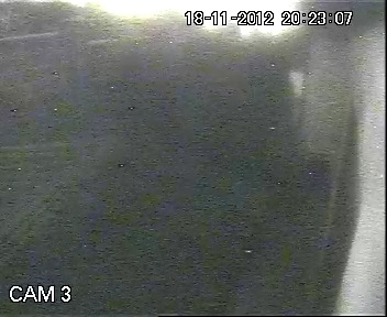

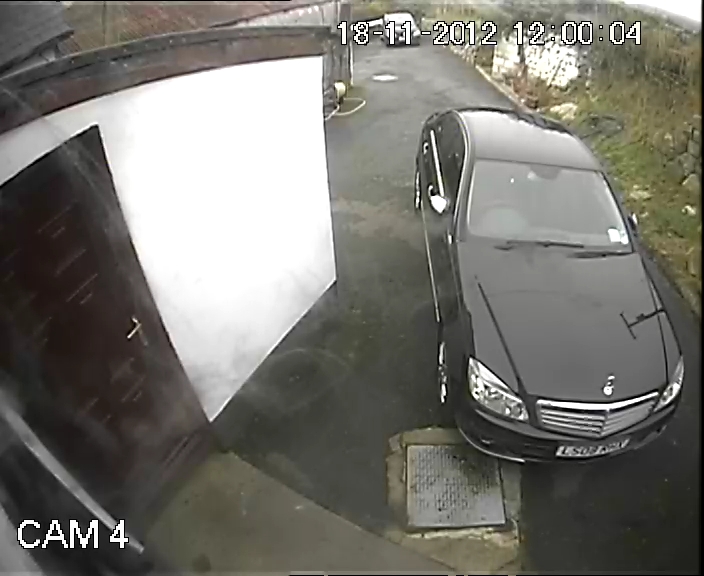

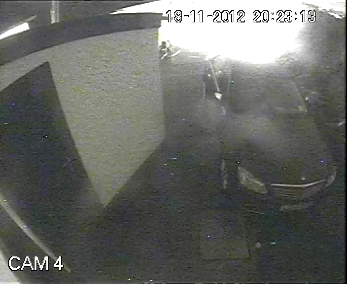

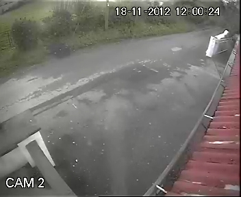

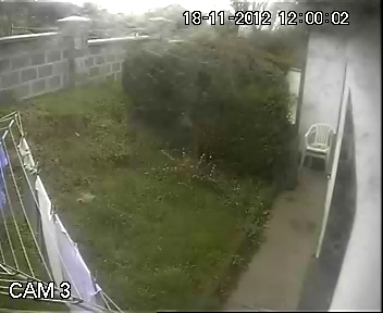

Hi my budget is between £2000 and £3500 and i need four out door cameras that will see in darkness and show me a crystal clear picture i as assume i need infa red to do this? as they will be out door weatherproof i am looking at back yard side and front pathways not sure on the viewing angle no preference on dome or bullet Continuous recording would need an nvr as for power what way are they normally powered? as for accessories im not sure i have attached pictures from my current system so you cans see what i need to cover

Hi there,
I would probably suggest a HikVision System, using 3mp cameras. Either their mini dome or mini bullets, these cameras are outdoor ready, POE , day/night cameras and come in 3 different focal lengths:
3mp dome : 2.8mm = 83 degree, 4mm = 63 degree, 6mm = 45 degree
3mp bullet: 4mm = 63 degree 6mm= 45 degree 12mm= 23 degree
I would suggest using a the HikVision 7608 to record with which is an 8 channel NVR that has its own built-in POE injector so the camera can be connect directly to it via a single cat 5 Ethernet cable for each camera. This NVR does not come with hard drives so you would have to install your own (we can supply and install them on request).
The most popular way of powering an IP CCTV camera is using as mentioned above power over ethernet or POE which allows us to get our power and network through one single cable. At one end of the cable you will have a camera and at the other you need a POE injector (for single camera usage) POE switch ( for multiple cameras) or some routers will have POE ports on them. To read up more on POE please look here : http://www.use-ip.co.uk/power-over-ethernet .
This system will cost roughly £896 - £1219 depending on which cameras you decide to go with and how much hard drive space you require ranging from 2tb - 8tb.
Hope this helps.
