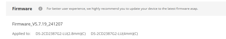

New G5 camera firmware V5.7.19 build 241207 available on some product pages

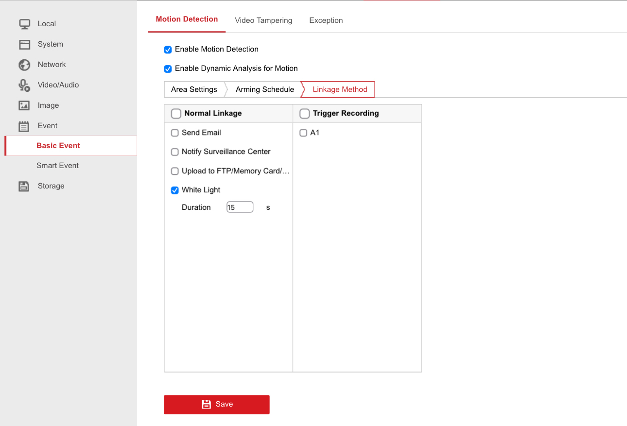

This is unfortunately missing from Motion Detection event configuration...
Testing for the moment but for more than an hour of timeline, this firmware also does not pass the Motion VCA data from "Enable Dynamic Analysis for Motion" to the NVR. Not even for Human on NXI-K...

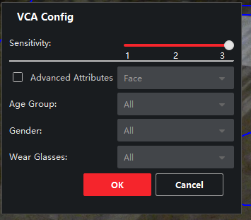

I just believe all issue is a matter of Sensitivity. Not the percentage kind of Sensitivity, but a real Sensitivity. The one VCA sensitivity that can be seen on iVMS4200 for Smart search
"Enable Dynamic Analysis for Motion" is not working at all since v5.7.17.

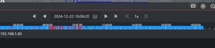

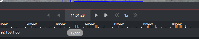

  • This is Motion VCA search(by Rule) before(v5.7.15) and after(v5.7.19) update. There are no Motion after 10:35am. Not even the Human at 11:48am

  • This is Motion non VCA search before(v5.7.15) and after(v5.7.19) update. There is no Motion files before because Human and Vehicle is enabled. There is Motion after 10:35am, but that's because this is not the results of a search by drawing rules, it is the files that are created when Notify Surveillance Center is enabled and Human Vehicle disabled. This is also the files that can be found by using the Search tab on NVR GUI.

  • This is Intrusion VCA Search(by Rule) before(v5.7.15) and after(v5.7.19) update. The are no Intrusion markers except those that is Human at 11:48am.

What I want to explaim to them, if they read our posts, is that what we see on my picture no2 should be seen as red marks on picture no1. This is so simple.
