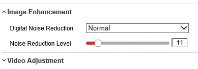

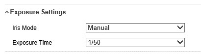

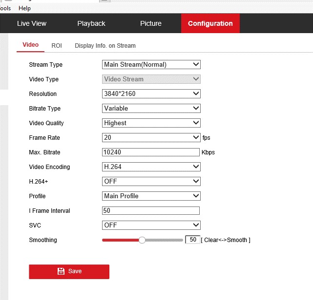

I am on the latest FW and here are my settings:

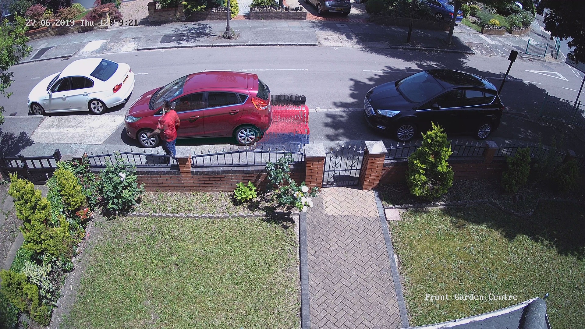

Here is sample:

I had the same issue, so I contacted hikvision directly, I ran it at 20fps and bitrate at 4096, then once it's smooth, try increasing the bitrate.
On the higher bitrate, I do find it slower for liveview/playback as it has much bigger filesize per second to stream.
Try this, set the frame rate and the I Frame Interval both to 20. Test that and see. If it still ghosts, keep the frame rate and I Frame rate interval at 20 but drop the bitrate to 4096. If that makes an improvement we can adjust from there. Keep us posted.

The way I got mine going was:
Upgrade camera and NVR to latest FW.
Now using H.265 not H.265+
Turned max bitrate down to 5120
Resolution is still highest. 3840x2160
