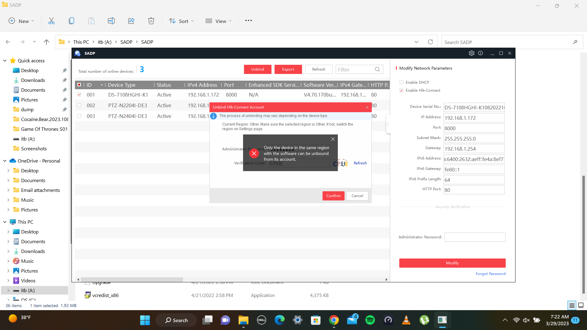

i recently bought a hik dvr off amazon and i can view ti on my phone and ivms 4200.i have been trying to set it up to view outside my local network, but it says it has been added by another user. i can view it on my phone and under account management it says region is andora and the user name is some numbers and letters. wtf?how can i change it? thanks

You should be able to unbind it using SADP by following these steps, and then connect it to your account:
tried that , i get this

OK, unfortunately, I think you will need to try and return this as that message suggests that it can only be used in Andorra due to the firmware being locked to that region.
This can happen with resellers that aren't authorised by Hikvision, as the equipment is not supplied to them by Hikvision's warehouse in that region, so there is no way of knowing where it is sourced from.
You could try installing firmware for your region if you can find it on Hikvision's website / download portals, but I'm not sure if it will actually allow you to install that firmware.
