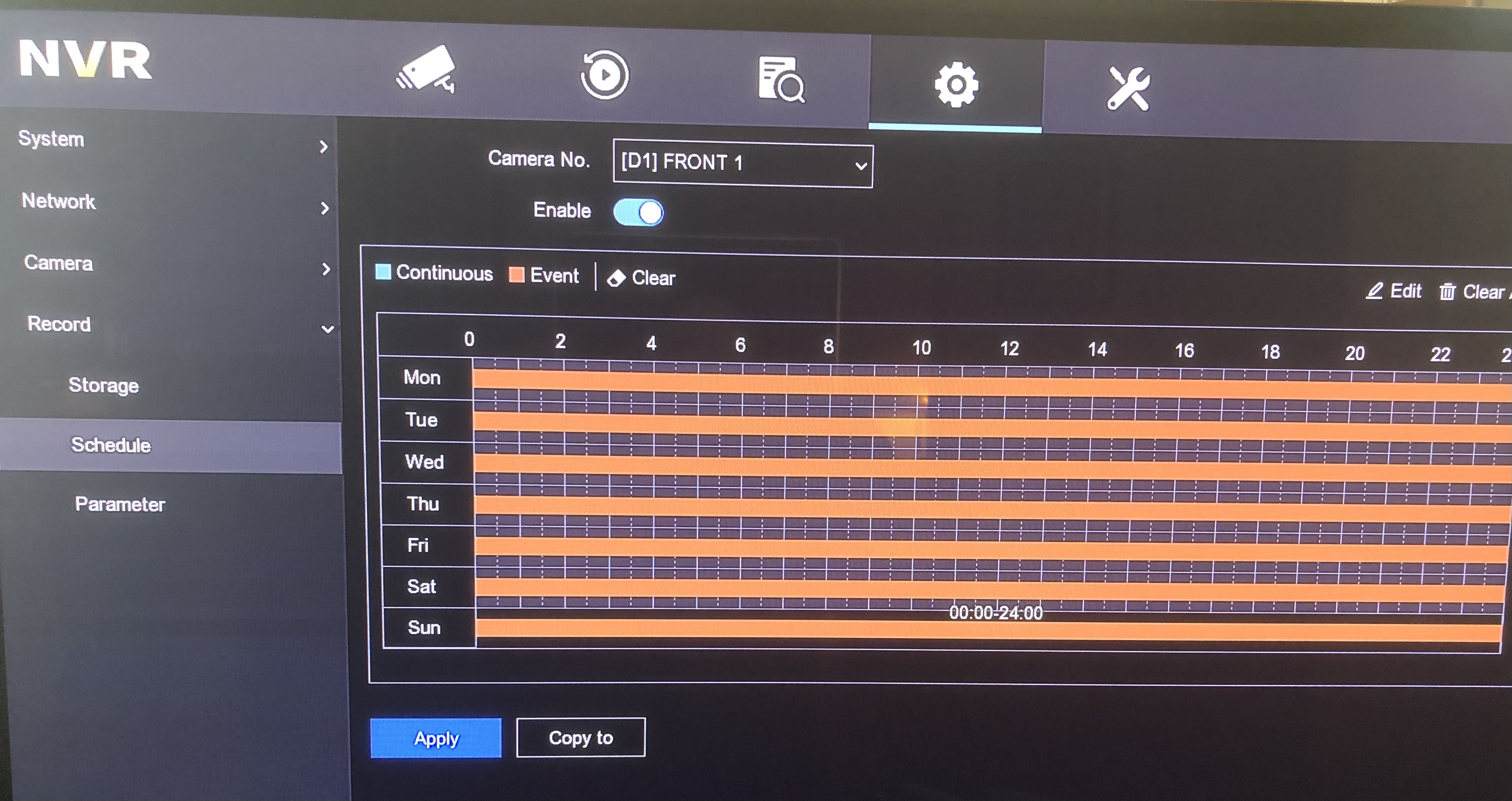

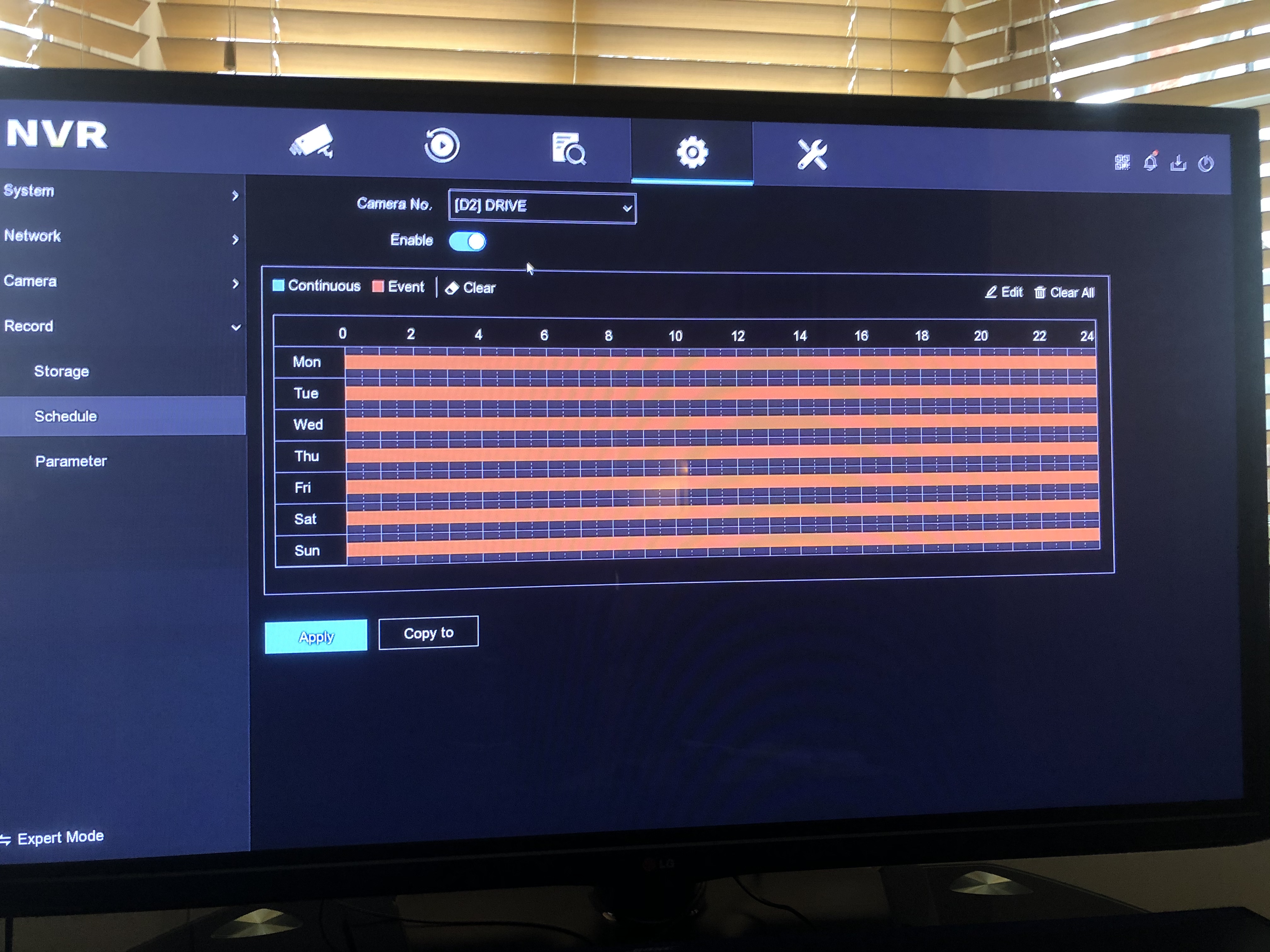

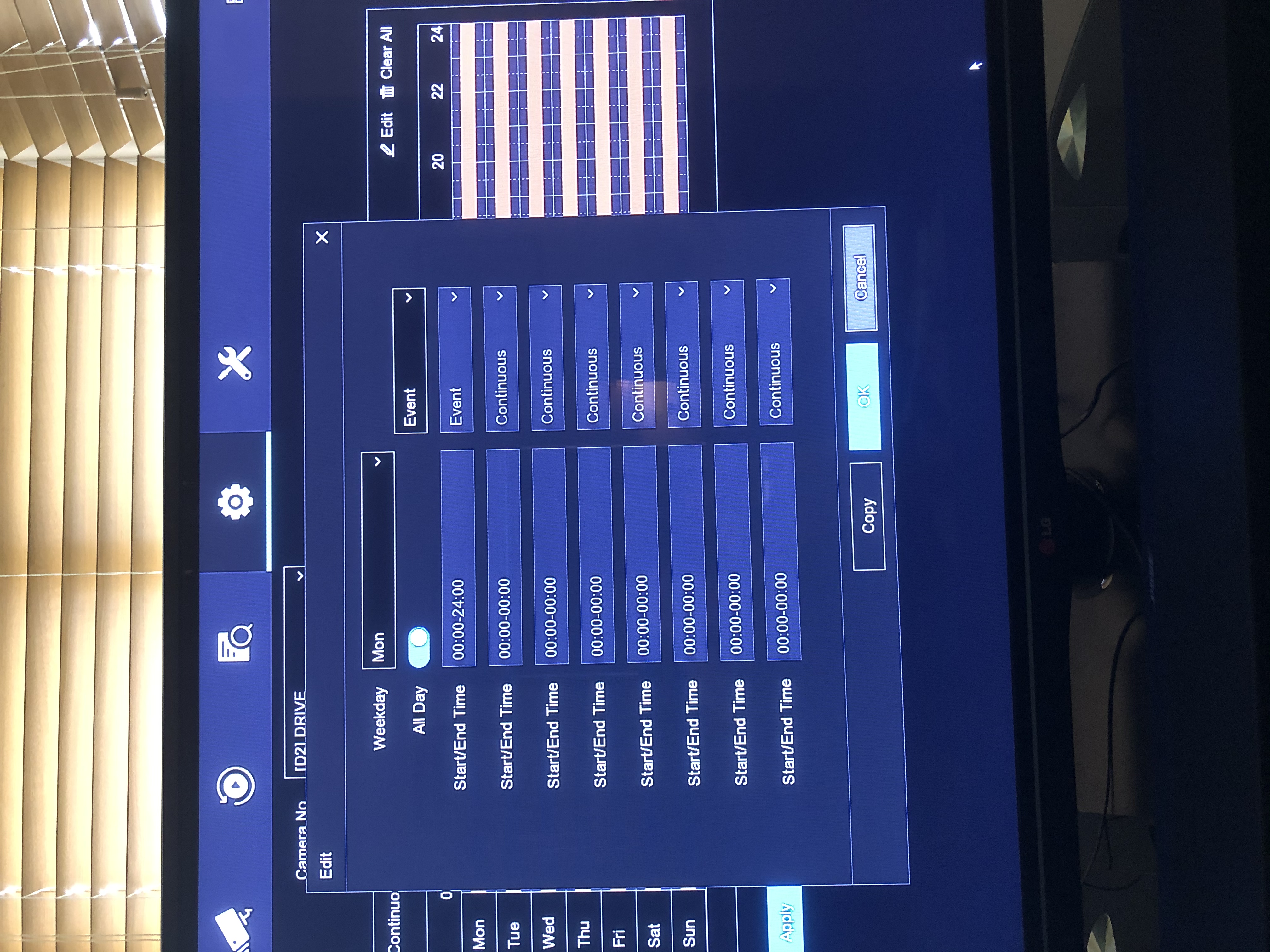

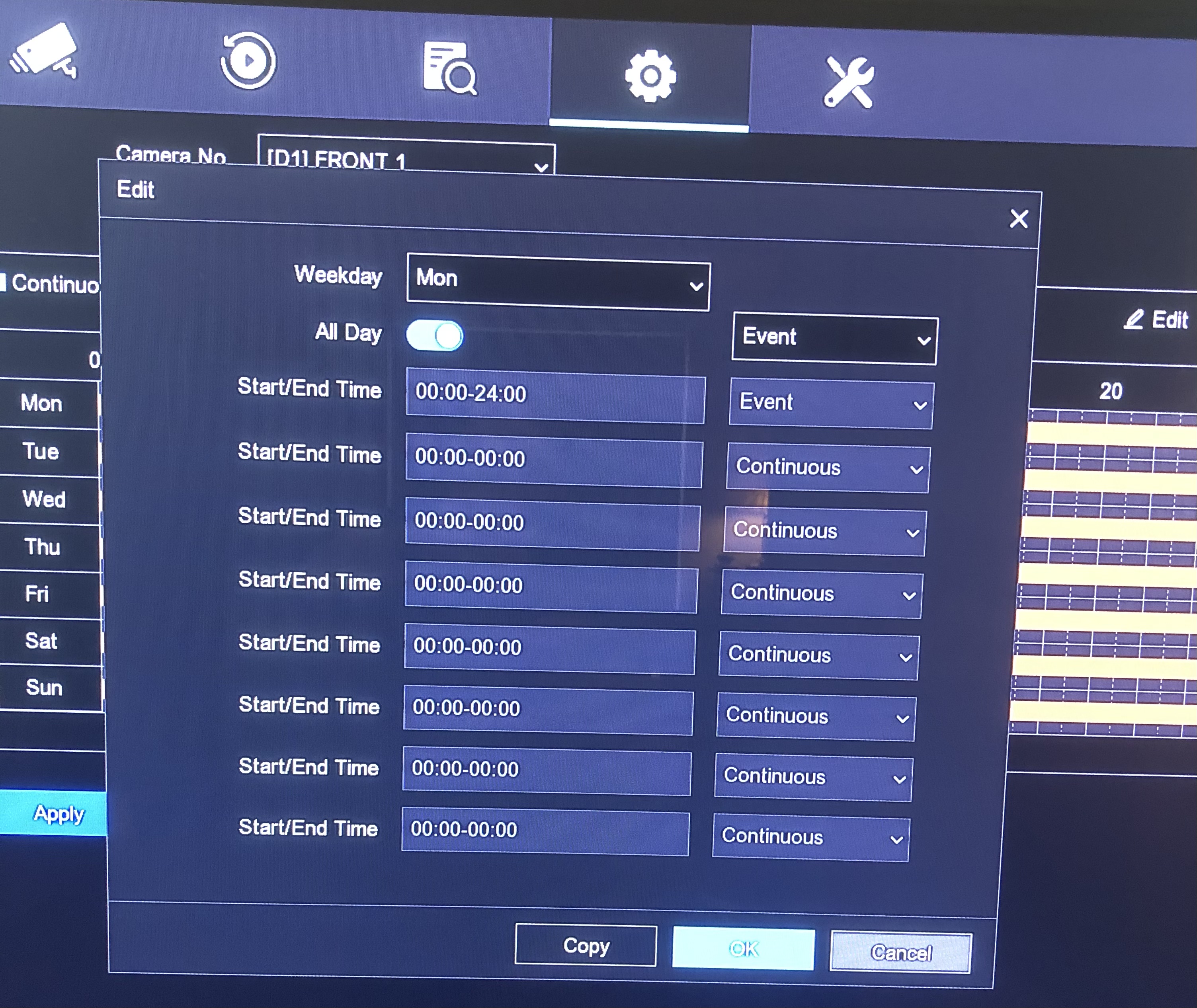

Hi. Thanks for your reply. The first 2 images are of the camera settings for the one that does not record on motion.
The 3rd and 4th images are from a camera which does record on motion. I can’t see any difference hence my confusion.

Those are just the recording schedules you're showing. The NVR will record the streams from the cameras during that time period when an event occurs. However first the motion detection event needs to be configured for each of the cameras. Check those settings for each camera in the NVR menu. You should have (for each camera):
- Motion Detection enabled
- In Area - the grid drawn and sensitivity set
- In Arming Schedule - this should be set to continuous (or whatever times you want it to be)
- In Linkage Action - the trigger channel box for the corresponding camera should be ticked (it is by default)
Thank you so much. This has resolved the problem and all the cameras are working ok now.
