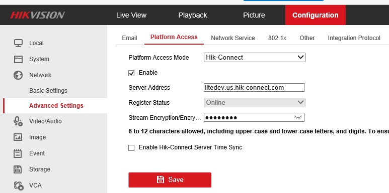

So its working now, however I find when loading a camera its still on the slow, not sure if there is a way to improve that or not? I'm on 5ghz wireless network & before it was almost instant using the same router, Asus RT-AC5300
Thank you so I finally figured it out! I was entering the wrong Verification key LOL! This is what happens when you setup systems for friends/family you mix things up. But thank you so much if it was not for you I would not of noticed it.
It's likely that the image encryption is slowing it down due to additional processing. You can turn it off in the NVR settings under Network > Advanced > Platform Access > Stream Encryption. Allternatively in Hik-Connect, click on your Cloud connection (not the local one) to load the images then click the 3 dot menu > Settings and turn off Image and Video Encryption there.
Do I don't seem to have the option to just turn off encryption. If I uncheck the enabled box I can no longer stream through the cloud version.
When I checked through the hikvision app on my phone the option is there but its turned off.
Any other suggestions?
If the 'local' device was added as described in my earlier post you wouldn't be prompted for a verification/encrtyption key as it is not needed unless encryption is turned on. The option to disable encryption isn't available from a browser menu though. You would need to check it directly on the on screen menu of a monitor/TV connected to the NVR in Network Settings > Platform Access.
Ah I see, I will need to check on the actual NVR then vs computer.

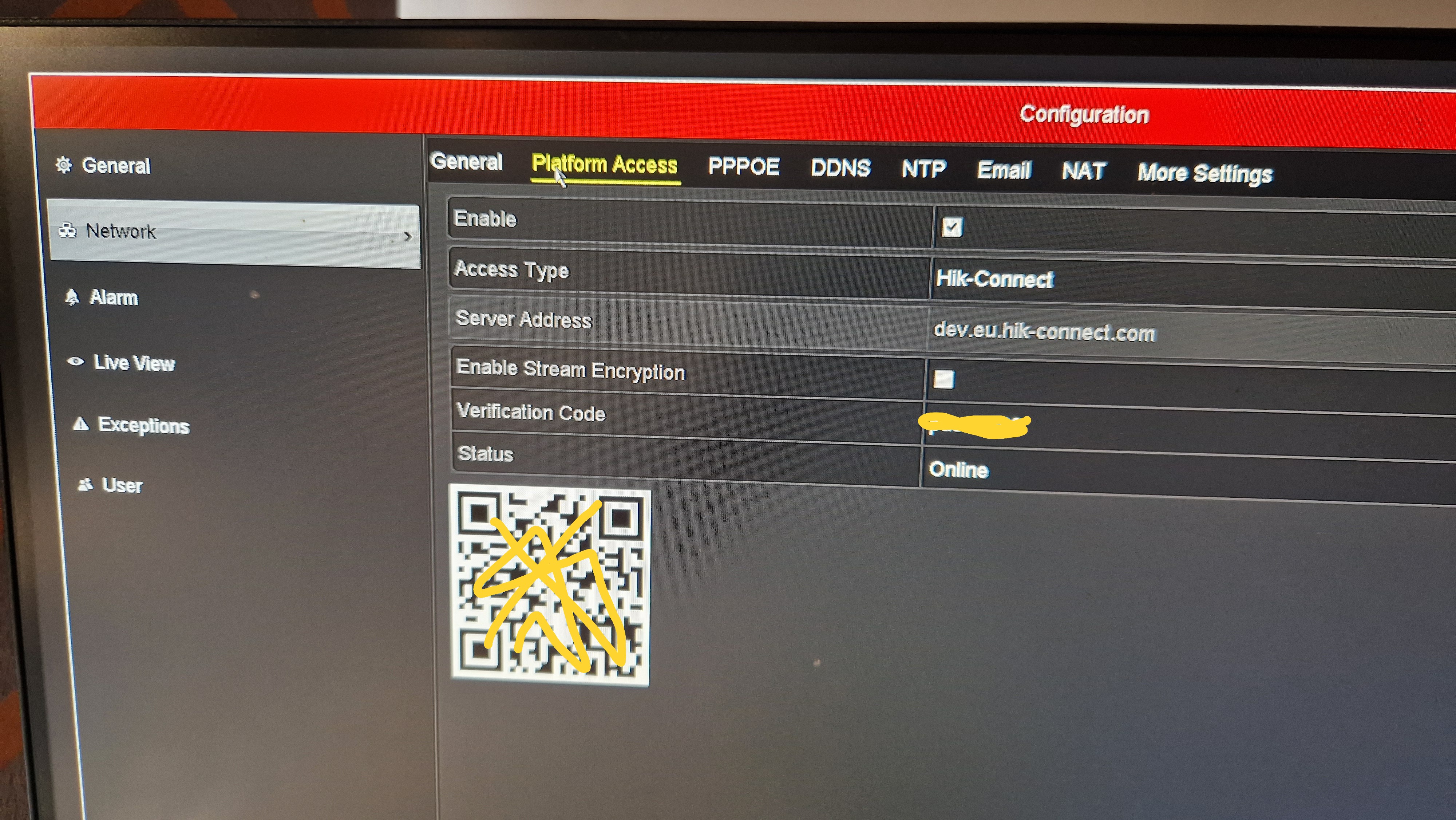

I’m am struggling badly with this. Spent 2 days trying to figure out why my cameras are offline on the app when I’m away from Wi-Fi and for no apparent reason.
Could you possibly let me know what you meant in entering the wrong verification key. I see this in platform access but as I understand this is where you create the key. Is there some where else I need to input this key to enable access back to the app?
When you add the cameras to your mobile app, right before it tries to load the cameras there is a lock symbol on each one. If you click on it it will then as for this verification key. I was typing it in wrong which is why it never worked properly for me.
You may need to add the cameras to your mobile app again then you will get this prompt.
