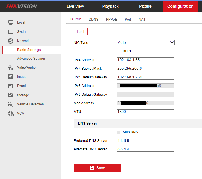

Have you configured your network settings?
Hi , maybe you have problems in router ports and chech the dvr/nvr ports also. The network confuguration (ip / dns /getway...) its variables .juste chech the modem and set the dvr/nvr in same ip rang. And dont forget to check the ports
I remade manualy all parameters ports (80, 8000 and 554) an DNS (8.8.8.8 and 8.8.4.4) but there is always the same problem, dev.hik-connect.com is always offline.
I'm lost thank you to help me.
With best regards
Mickaël

Just your external IP and the port. It may only work when you are not on the LAN, depends on the router.
I made it but I always the same problem, I think that I Have a problem with router ....
