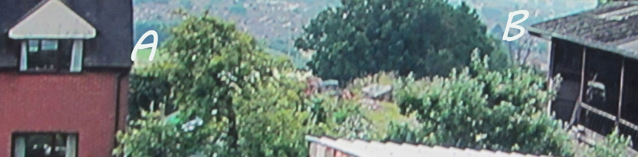

We have an Hikvision DVR8 working with 6 cameras coax connected, we would now like to move one camera to a new location which is difficult to wire. The new site has an approx 35m straight aerial view of the old site, see attached with “B” being the new site. Can we mix wireless with wired and what would we need? bot.yard.jpg
Yes you can.
You'll need a wireless link suitable for analogue cameras such as this, and power at the camera location to power the camera and wireless sender.
Double-check with the provider of the link that you choose that it is suitable for your camera; analogue cameras used to be all the same, but nowadays there are many variations.
Yes you can.
Thank you, I am pricing these out.
Did wander if would need a new wtreless camera and reciever?
would having two mobile telephone mast (one handling local hospital 999 calls} also on site be a problem?
