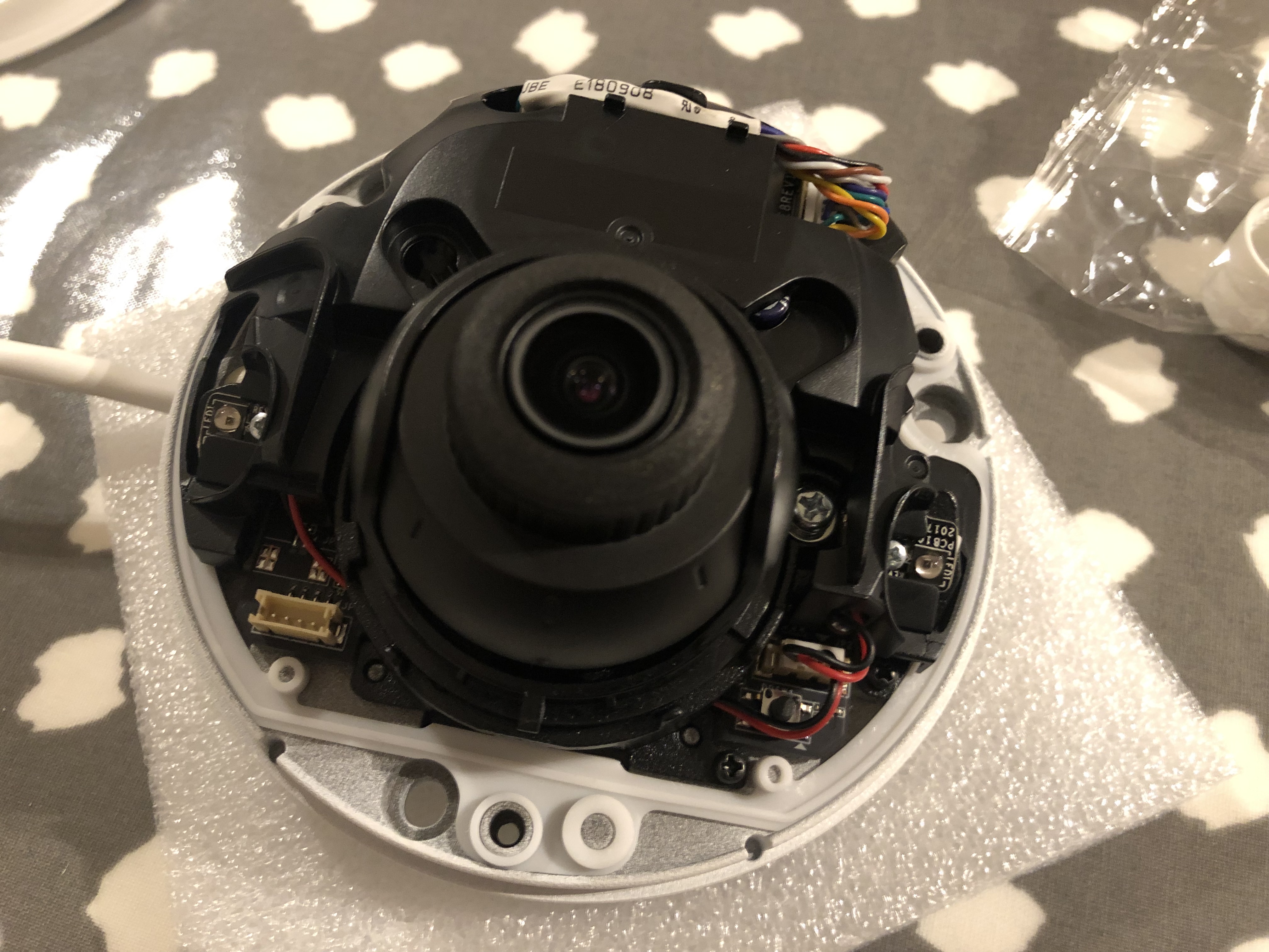

Hi all,
Camera: DS-2CD2545FWD-I
I’m trying to work out how to move my lens slightly right as it’s going to be placed on a wall.
The manual seems to show two models.
One model listed has a hex screw on the top which I can’t see on mine and the other says use a little round tool that fits over the lens to turn it but I didn’t get that in my camera box.
Can anyone shed some light.
Sorry if I’m asking a silly question. I’ve had a long day and can’t seem to see it.
Camera photo attached.
Thanks again.

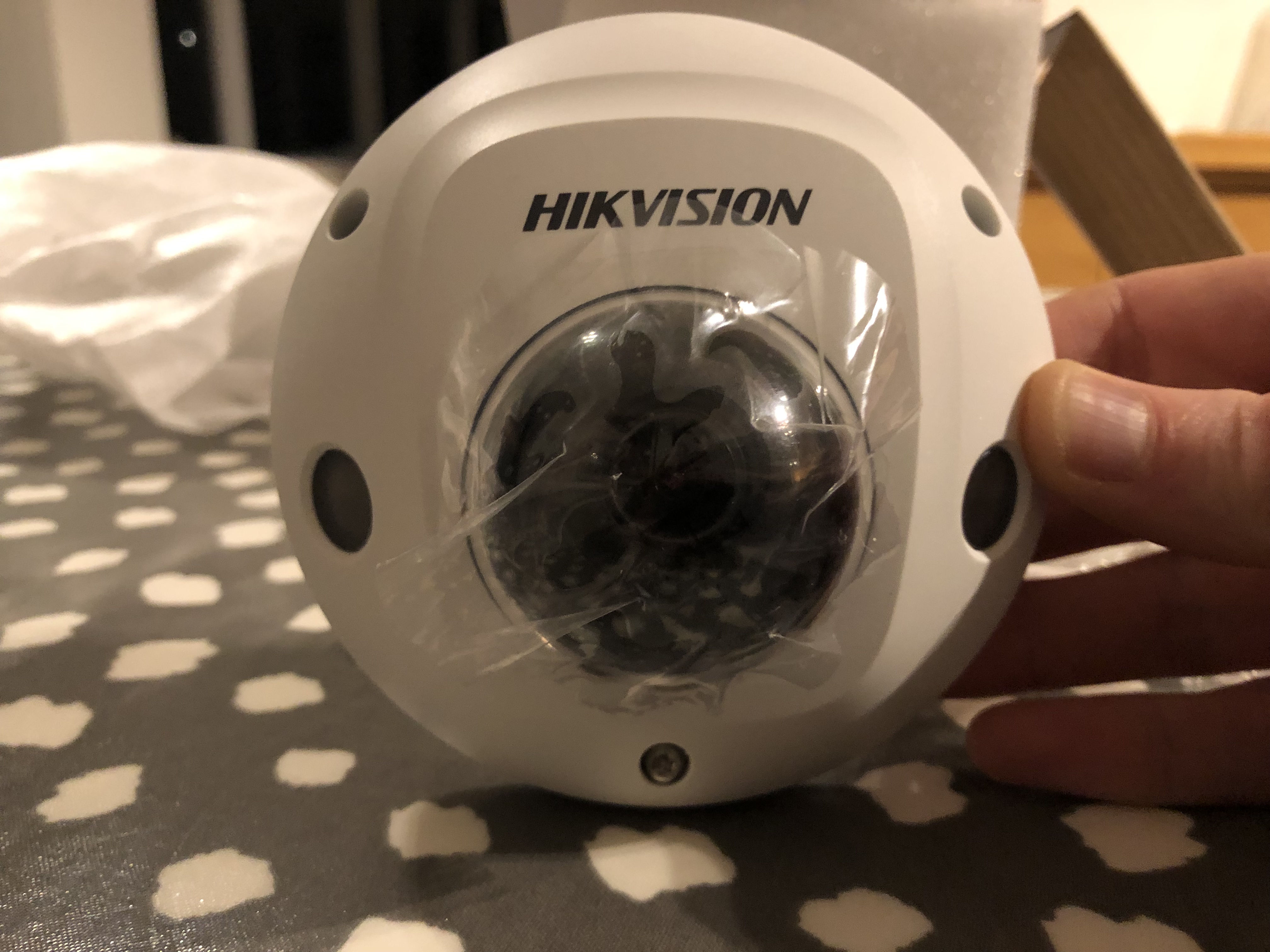

Sorry for yet another question....
If I have it mounted on a wall in the position of the photo below will the image be the right way round or upside down?

The manual shows the hex tool but you don't really need it, you can move the lens using your fingers, just hold the foamy ring around the outside of the lens and avoid touching the glass. You don't need to loosen anything.
Yep that's the right way up :)
