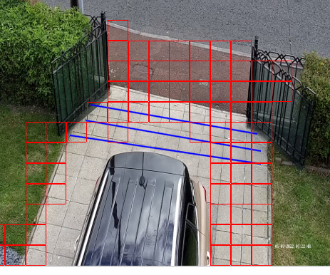

When setting smart events (Line crossing/intrusion detection) the line/area locks into place even when moving the camera. With motion detection, the area seems to follow the camera view. Is there a way to lock this in place?

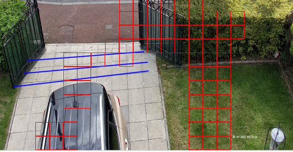

During the day (preset 1), All lines and motion detection areas are where they should be.
At night (preset 2) is a more zoomed in, slightly different angle view. The Lines have remained where they were set, but the motion area has followed the camera to the preset 2 view.

I've chased them and they finally got back to me with the answer I expected:
Unfortunately, the motion detection grid cannot be fixed on a point, so it will always move with the PTZs movements.
If you want fixed event detection areas, I would suggest to use smart events such as line crossing or intrusion.
