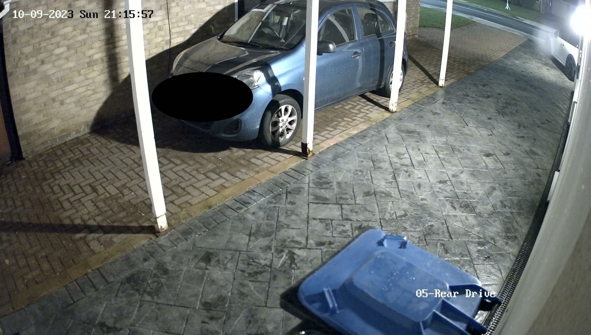

It's surprising how little light the ColorVu cameras need to allow the integral white LED to be disabled. You certainly don't need a floodlight; I have a 6 watt warm white LED light controlled by a photocell located next to my side door. That's enough for me to get good colour images. You can see the light in the attached image in the top right corner (there's a bit of rain on the lens). That camera is a DS-2CD2387G2-IU 8mp turret at 1/100 second shutter, Day mode, LED off.
