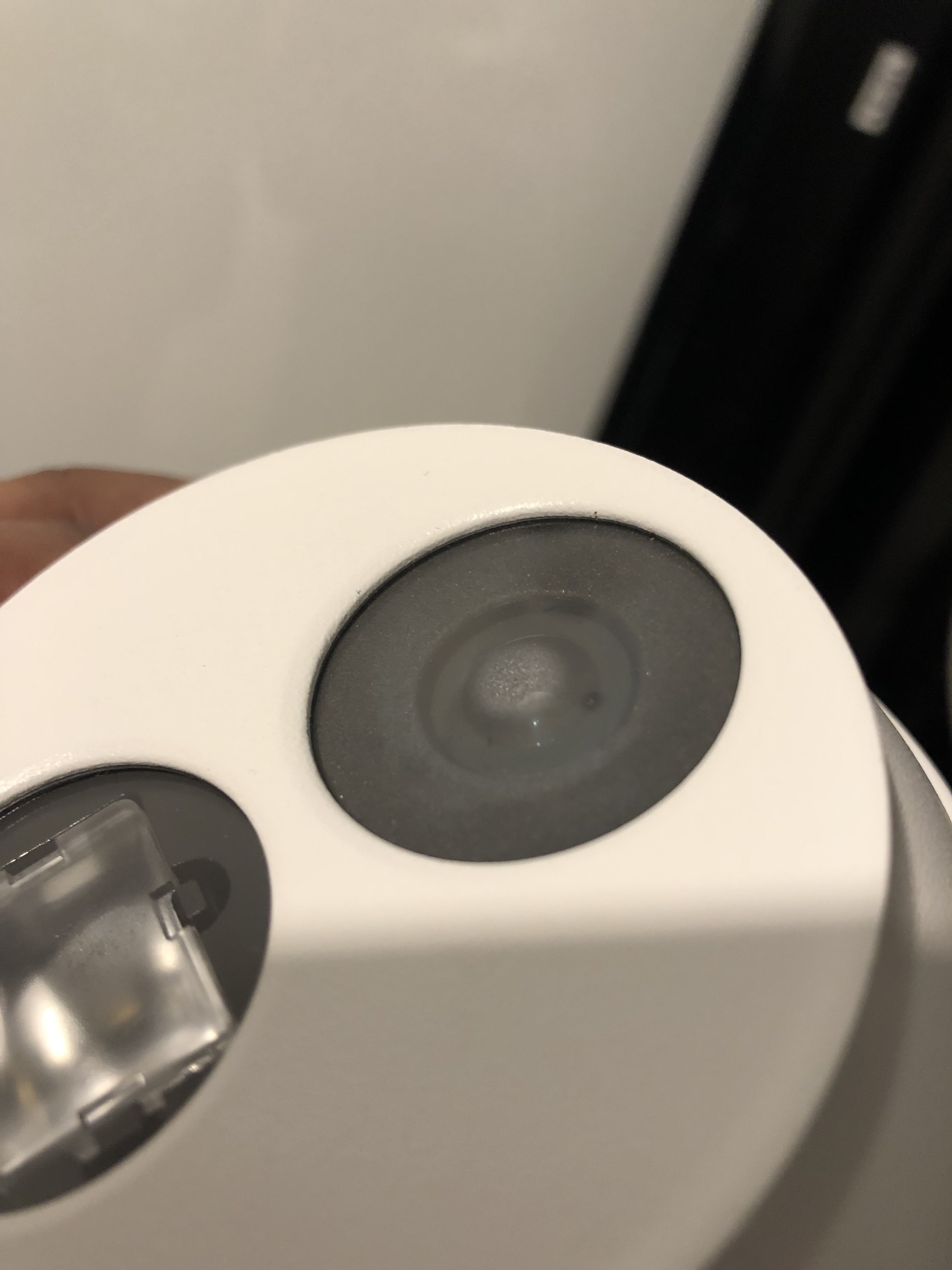

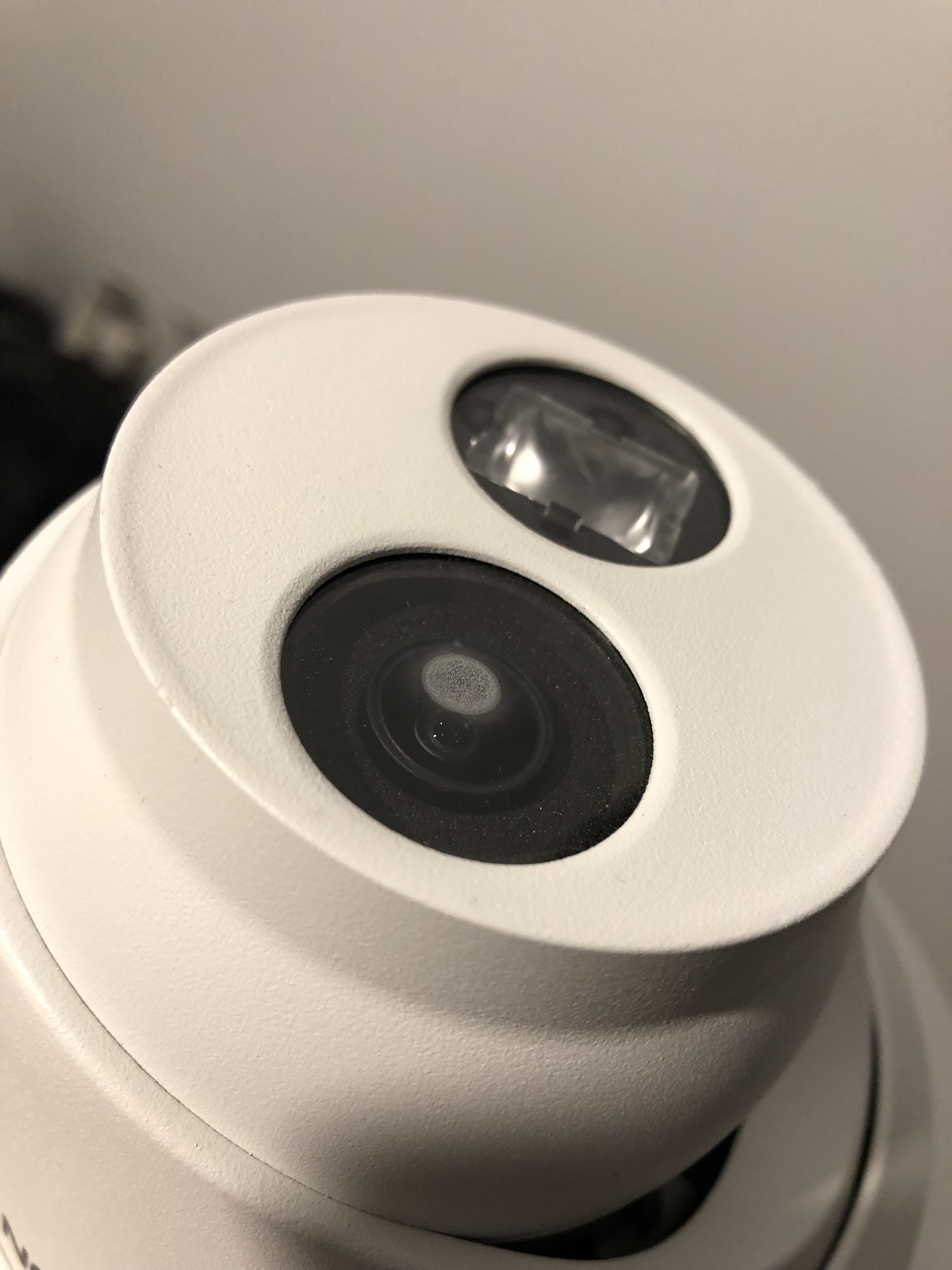

Hello, I hope you can help/advise.
I purchased a number of HIK turret cameras a few weeks ago.
I’ve only just got round to starting to install them over Christmas. The first camera is now up and running but I’ve noticed that when it got dark outside the lens has fogged up with moisture on the inside.
Is this normal or a faulty camera/seal? Can I do anything about it?
Any advice most appreciated...

That would be silica gel I suspect which is the common answer I seem to keep on finding on the internet. My turret cameras didn’t come with any packs in them though so not sure if I’m missing them or if they may already be inside the turret!
Might take it apart today and look inside...
This should not happen.
You sometimes see this problem with cameras that have to be opened-up at installation - which if you perhaps install them on a damp day allows moisture to get inside.
As you know, the turret cameras are effectively a sealed ball in a yoke with a fly-lead that you connect to. You do not open them to install them.
As Nicholas says, Hikvision have traditionally included a small pouch of silica gel (beads) to dry-up any moisture inside a camera.
I don't know whether that is the case with the turret cameras, we'll check later this week.
Having said that it should not happen with turret cameras - it IS happening!
We saw one before Christmas - returned and currently on my desk (is fine indoors in dry/warm).
And have had two more reports from customers in addition to yours.
