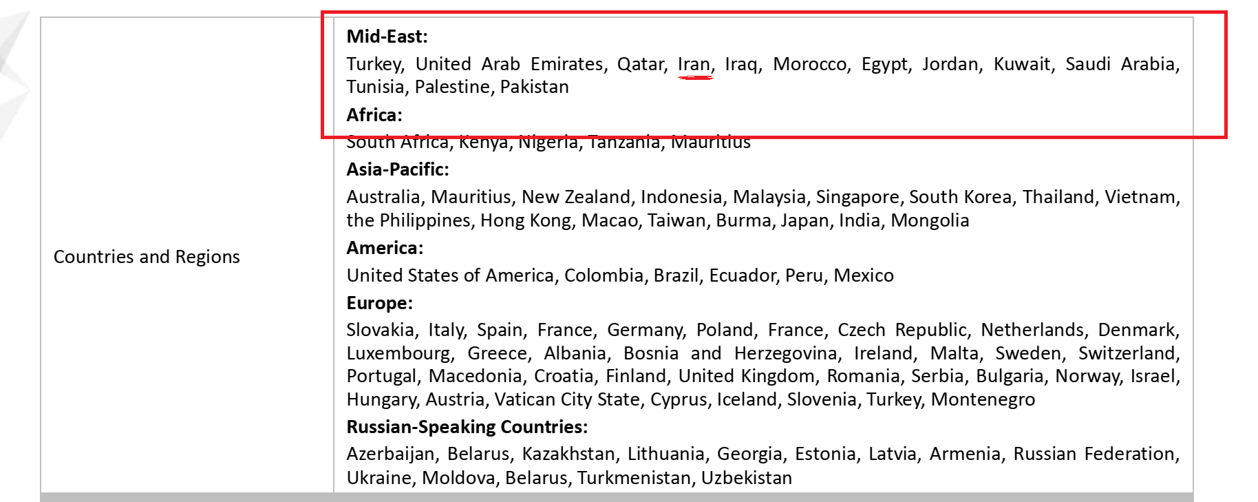

hi, i bought anpr camera with following model: DS-2CD4A26FWD-LZS/P (8-32mm)
before ordering i check its datasheet clearly it said that was support Middle East Country like kuwait,iran,pakistan,.....
but when i install it there is no option in region menu for these countries!!!
it detect plate with incorrect number and it shows Latin number instead of Arabic what should i do?
can some one guide me,
original firmware version : 5.4.7 Build 180309
some example picture taken:
As u can see plate number was completely wrong Correct number is 22 xx 73 22
i think it could not detect Arabic number. also i check a white paper about ANPR (which i download from hikvison official website) in that document they clearly said that they it could detect Arabic number and many countries related to it.

in country menu of camera even for Europe many countries are missing but in it's datasheet indicate them.

thanks for your reply they do not respond yet how ever i think maybe hikvision use customize firmware for each region because i download a firmware from USA site when i flash this into camera in country/menu region it show only two coutnry: USA and Canda
again i test this procedure with Russian site (ftp) this time there was 3 option: CIS/Europe/Europe & CIS so i think maybe there was a idk Middle East version firmware for fixing this issue.i search so much on web but nothing found related to Middle East fimrware or even a portal like Europe for searching their content,
