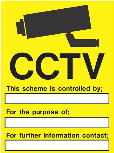

The accepted 'rule of thumb' always was:
  • A4-sized signs at pedestrian entrances to a site/building
  • A3-sized signs at vehicle entry points
The signs should state the purpose, the controller, and how to contact them:
Typically, the company name as the controller.
"Safety & Security" as the purpose.
A contact phone number, and possibly a job title, in the further information field.
