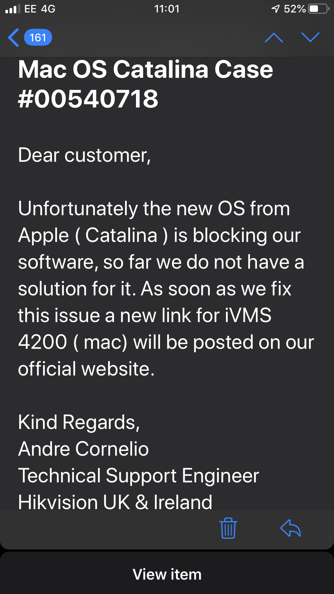

Just had an official reply from hikvision
Not good!!!

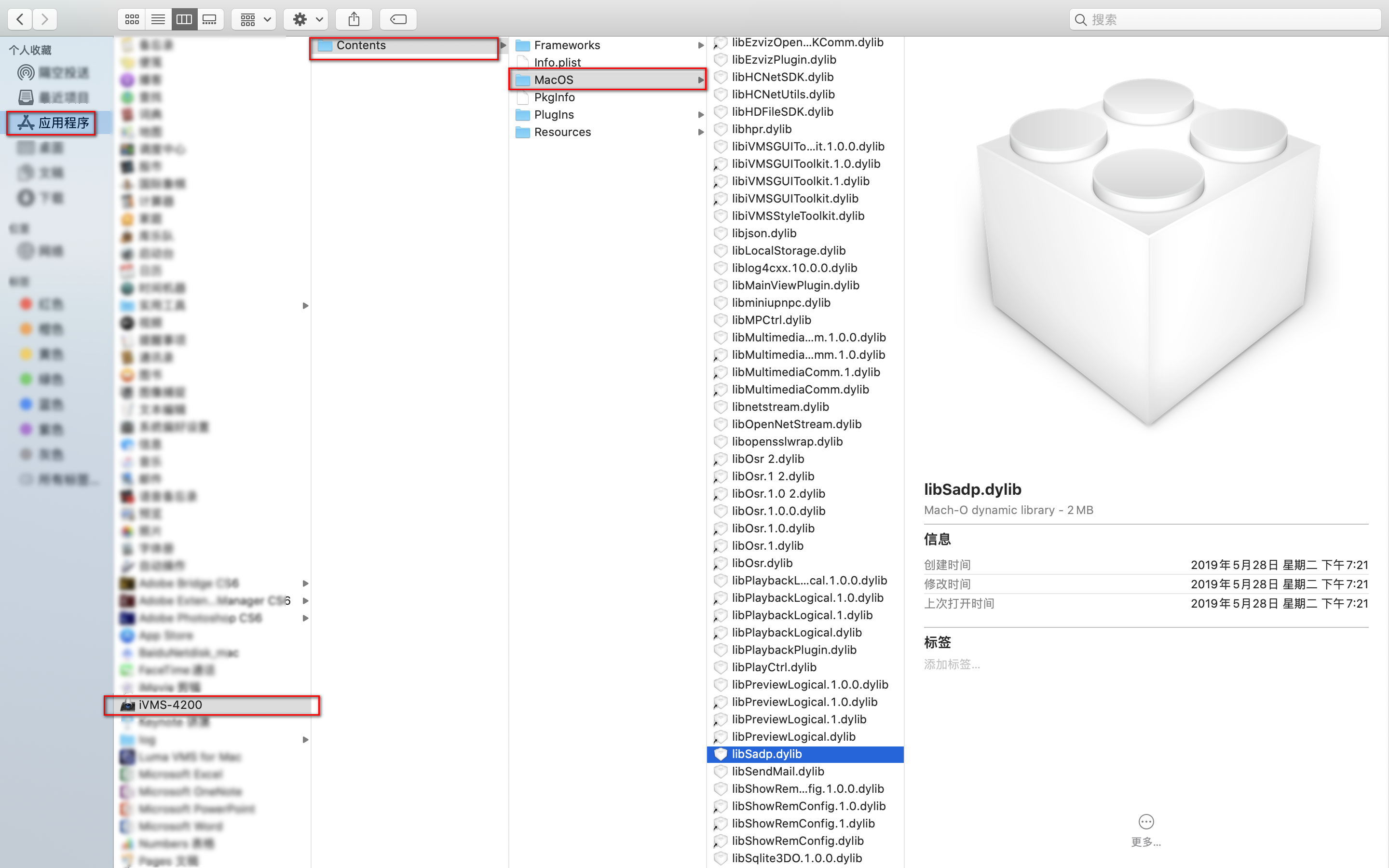

The fix they sent me is attached with instructions:
Dear customer,
Sorry for the inconvenience.
Please try to do as following steps:
1. Please decompress the file attached, which named "libSadp.dylib".
2. Put the extracted file in the 4200 installation root directory(as picture attached), and replace the original file.
3.Running 4200 again.
I've tried it and now the iVMS4200 is working fine for me.
Hopefully it helps others.
