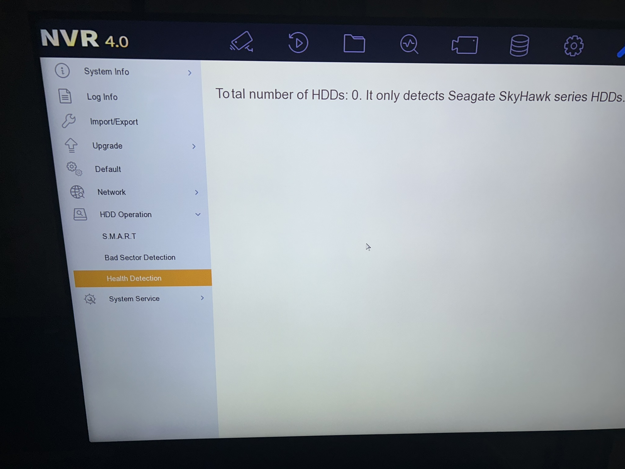

With this latest version 4.63.025 it seems Western Digital drives are no longer detected by menu item "Maintenance/HDD Operation/Health Detection". They were detected in prior versions.
