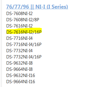

P.S. we also have a DS-7616NI-I2 / 16P at our other depot that has never been updated, anyone know what the latest firmware is for that one?
A great resource for firmware links (and so much more) is this forum. Have a look here:
Hikvision Firmware for your NVR
Which points here:
Firmware for DS-7616NI-I2
