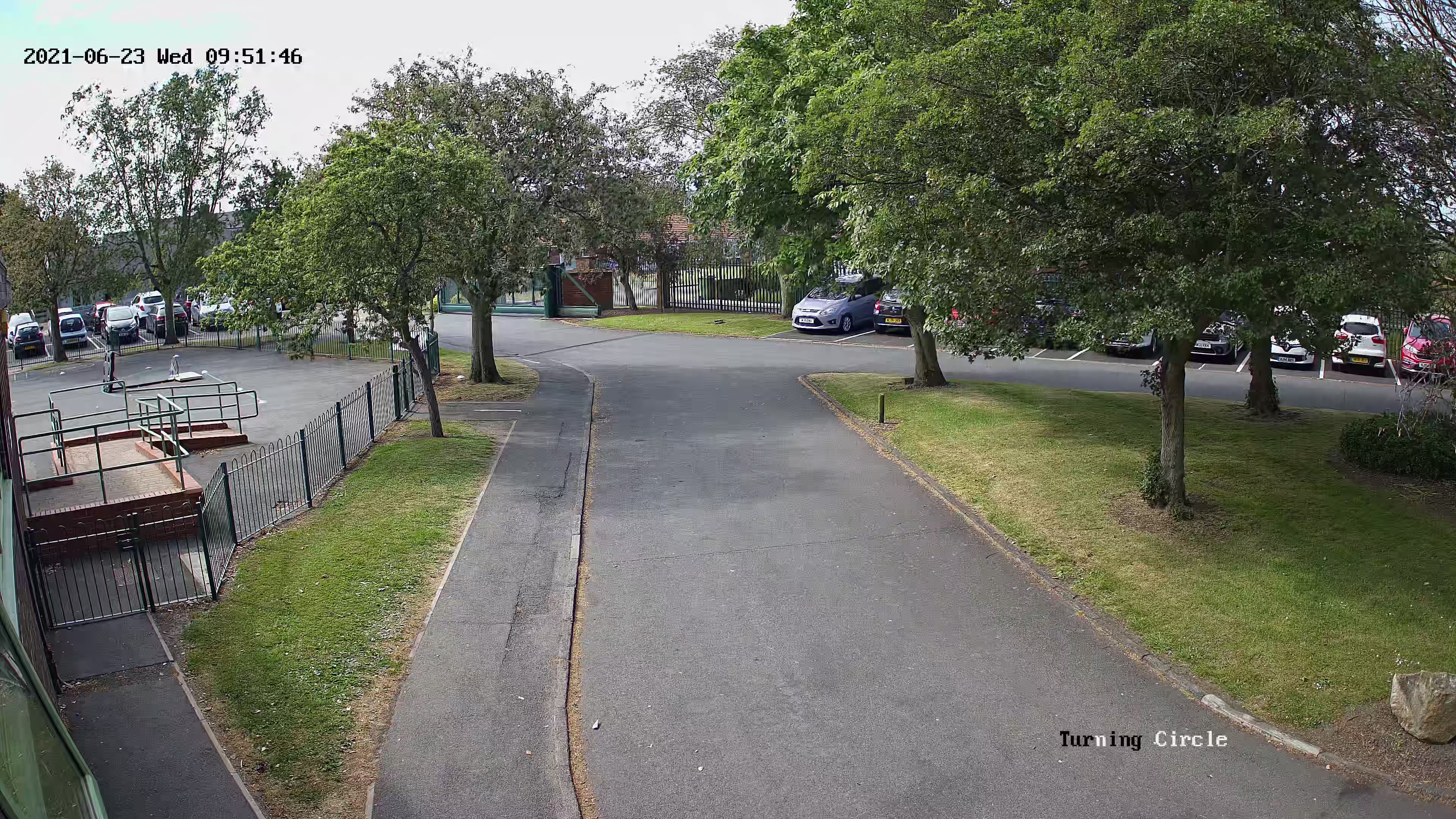

I've just had a DS-2CD2T87G2-L 4mm installed. Obviously it defaulted to 4k 3840*2160 and this is how it was positioned on the wall.

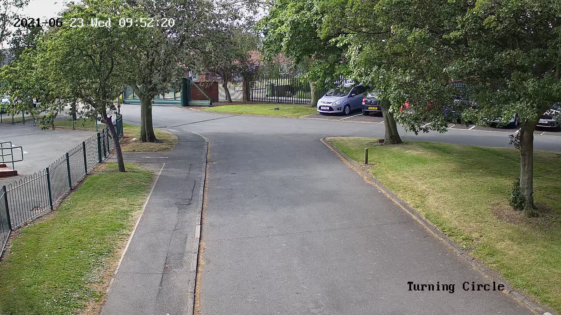

At the moment I'm running all my cameras at 1920*1080 but I noticed when changing this new camera to that resolution it is chopping the sides of the image off, almost like the lens has gone from 4mm to 6mm.
Is there a setting I'm missing? I haven't come across this before.
4k:
1080p:
I think it is just a factor of the relationship between the physical sensor size, and scaling to the aspect ratio of 1920 x 1080.
I don't think there is a 'fix'.
