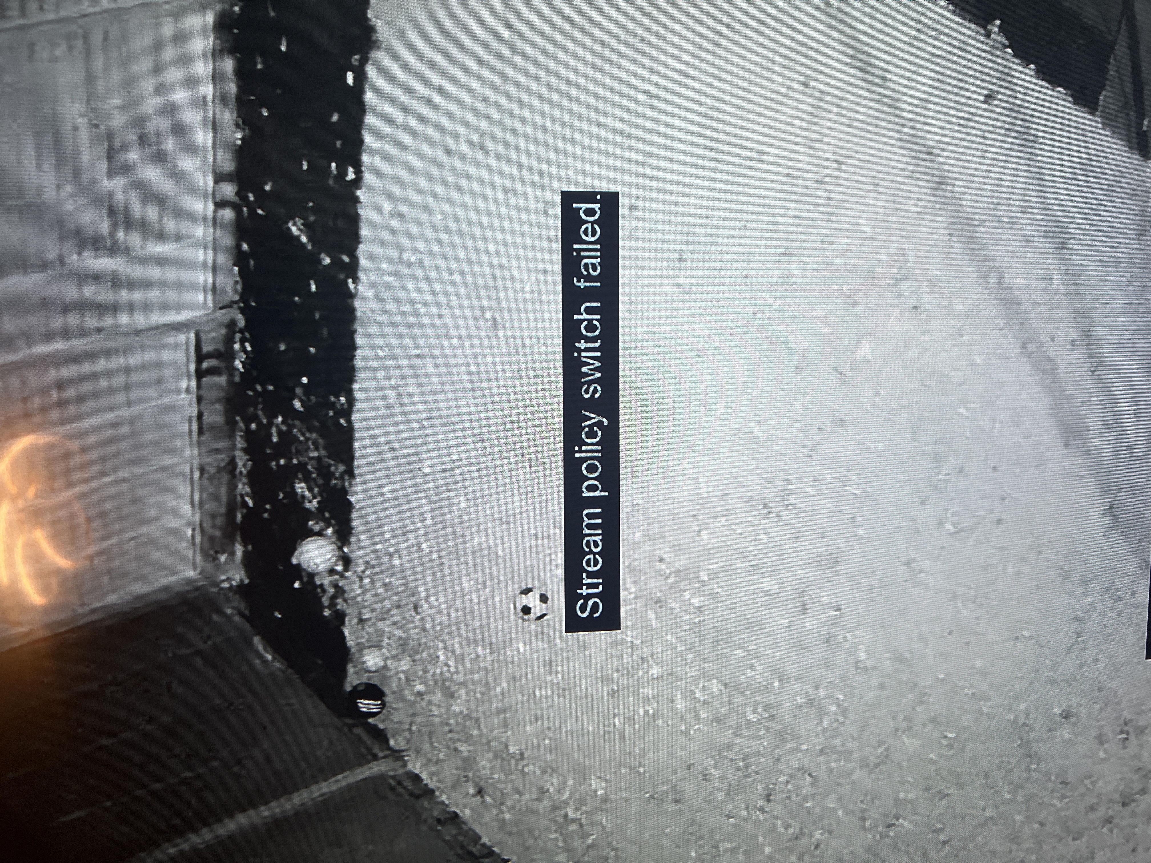

I have lost sub stream on 2 of my 4 cameras.
Had this problem before but resolved it by climbing on a ladder and doing a hard reset. But I don’t want to be doing this every time.
Can I do a hard reset any other way? Why does this always happen when I have a power cut
On the hik app I can see the 2 cameras only in hd it won’t let me put on basic.
