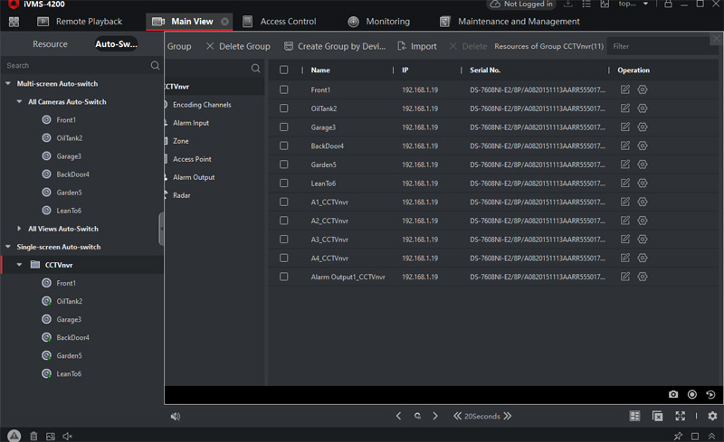

The screen seems slow to refresh and sometimes I can see web pages through the app or the previous screen of the app in the Main View section.
(See image)
Anyone any ideas?

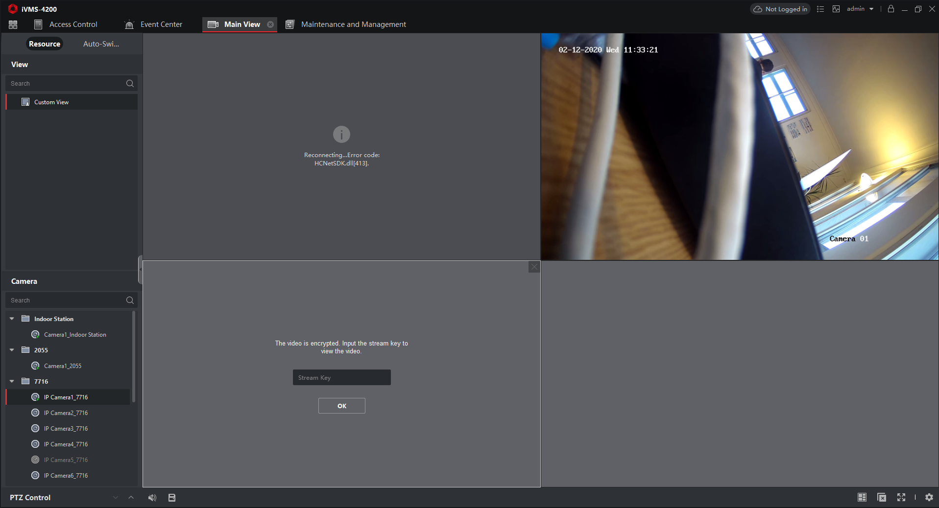

Hi Rick47
Our initial thought was that this would be an encryption issue with the camera, but the version of iVMS-4200 that you have installed should give a prompt for a stream key if this was the case like below:
This isn't an issue that we've seen before on the program, we're running the same version of the software as you and haven't seen any of these issues. Sorry I can't be of more help, hopefully someone else here might have experienced something similar before. If not you might need to enquire with whoever it was you purchased the equipment with.
