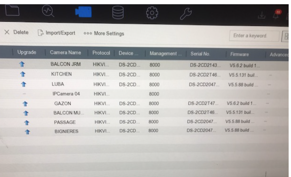

2 - Do any of the cameras have particularly out of date firmware? if you go to the Camera menu where you can see all of the images, click the icon in the top right corner to switch to list view and let us know the full model numbers and firmware version of each camera.

2- The whole installation is brand new, supplied from Germany after a waiting time of 2 months. I attach a screen shot.
