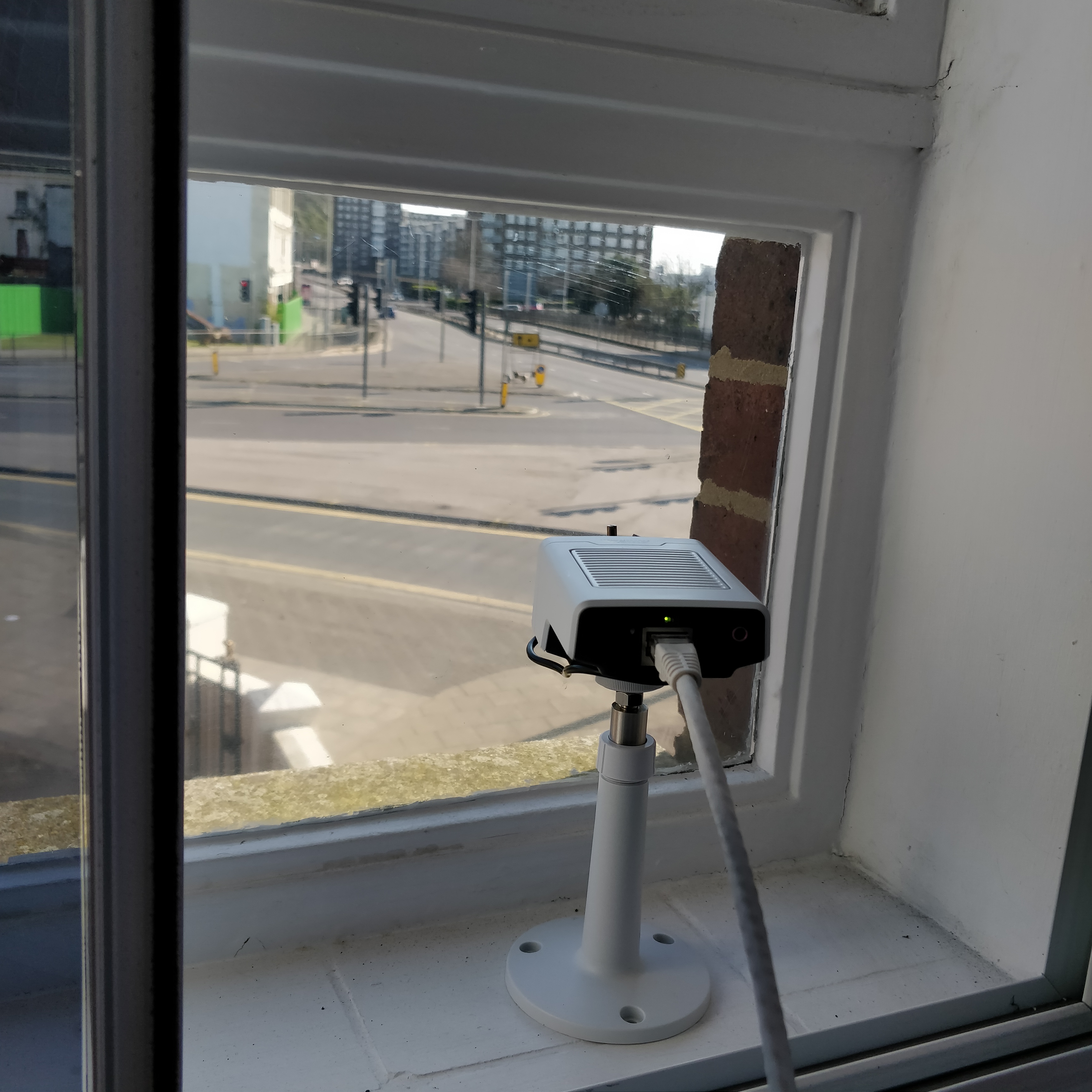

We will shortly publish a link to a demo Axis M1135 livestream.
The Axis P1367 camera has been the most popular model purchased by churches.
Where the advanced capabilities of an indoor PTZ for live streaming are required, then the Axis V5915.
This demo live stream on YouTube is of a relatively basic Axis 2MP network camera (the Axis M1135) - plus Camstreamer - that's all i.e. no PC, software, streaming device, relay station (just the camera, on our existing office network, pointed out through the window).
Undoubtedly there are cheaper ways of achieving this, but if you include time and technical complexity then we commend this solution to you for its simplicity and quality.
The view is out of our office window of the main A20 dual carriageway, about 1 mile prior to the Port of Dover (normally a road packed continuously with traffic headed to and from the UK's gateway to Europe).
That is the white cliffs of Dover in the background, and Dover's famously painted-over Banksy of the European flag to the left.
The large building is the Gateway Flats, a large block of mostly private residential flats overlooking the English Channel.
