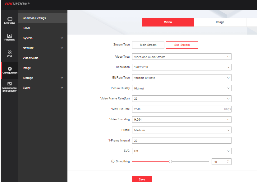

You can set them on the camera's web GUI directly or on the NVR... here are the setting on the camera directly:
Also, if this issue is bandwidth/Wi-Fi speed, H.265 is better because it will compress the stream more... If the issue is the Fire tablets struggling to keep up/decode, then H.264 might be better...

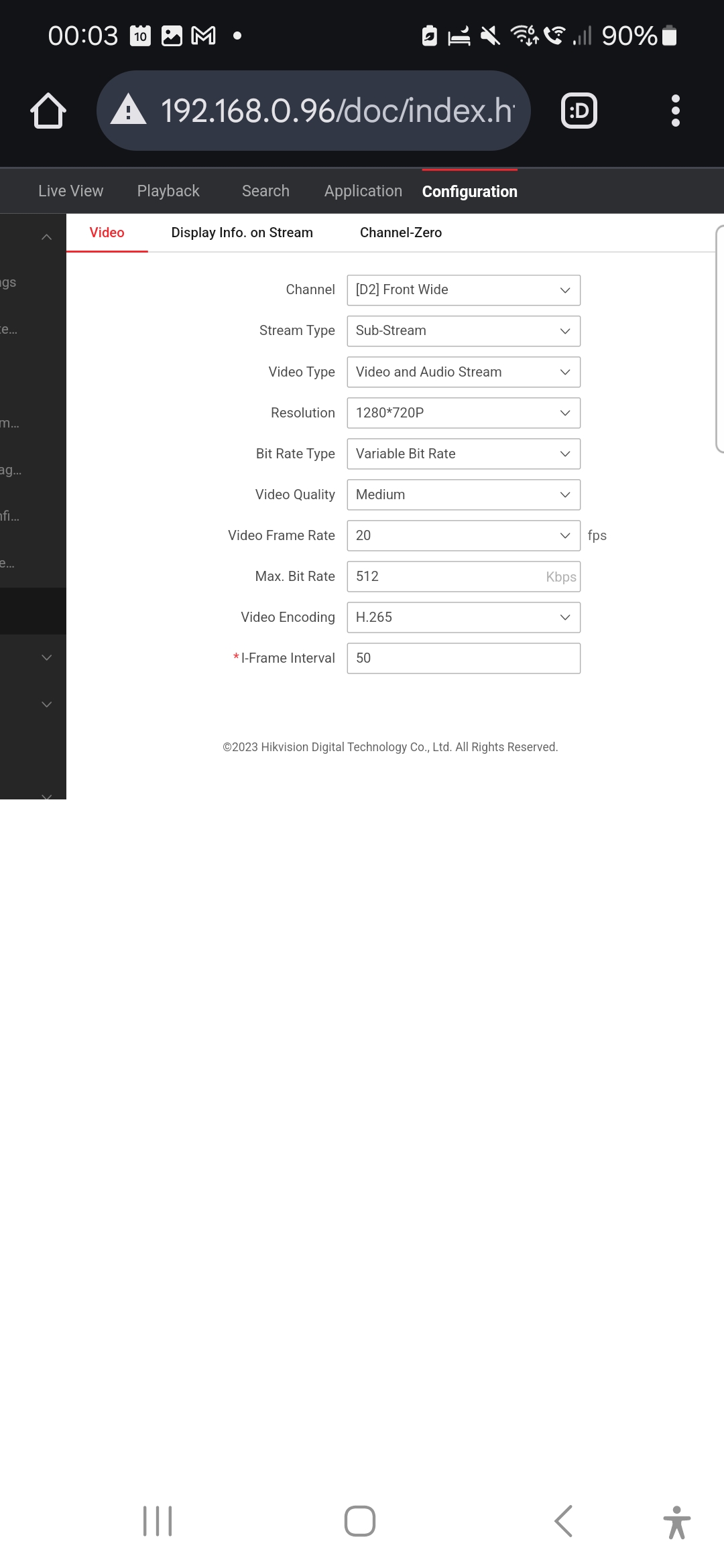

I don't have that option show up on my NVR config screen. Just the above

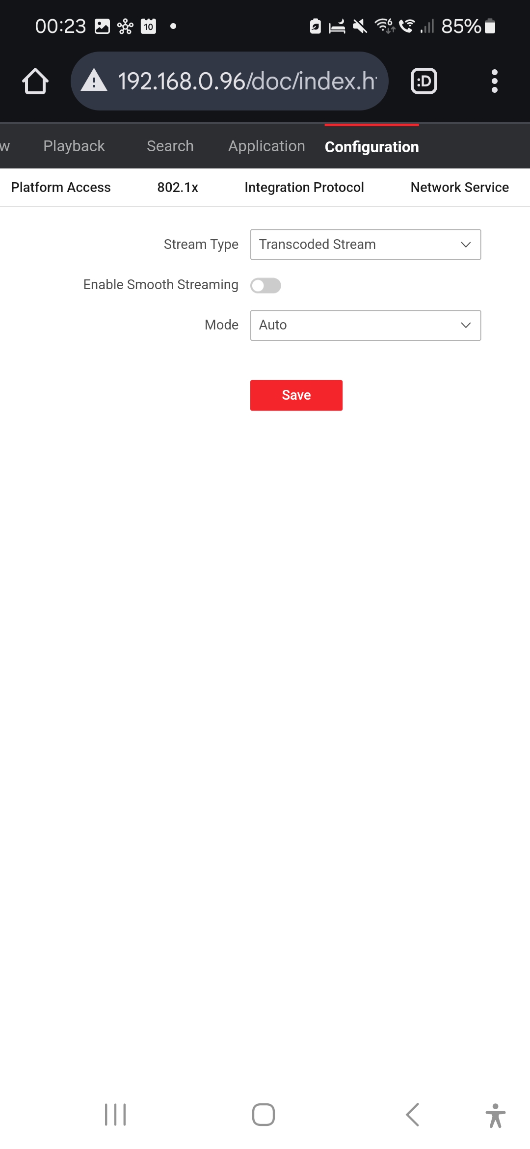

And I have this on the video setting page
I did find something called smooth streaming but which only applies to the "transcoded stream" not the sub stream. So I've turned it off.
I assume the transcoded stream is something else?

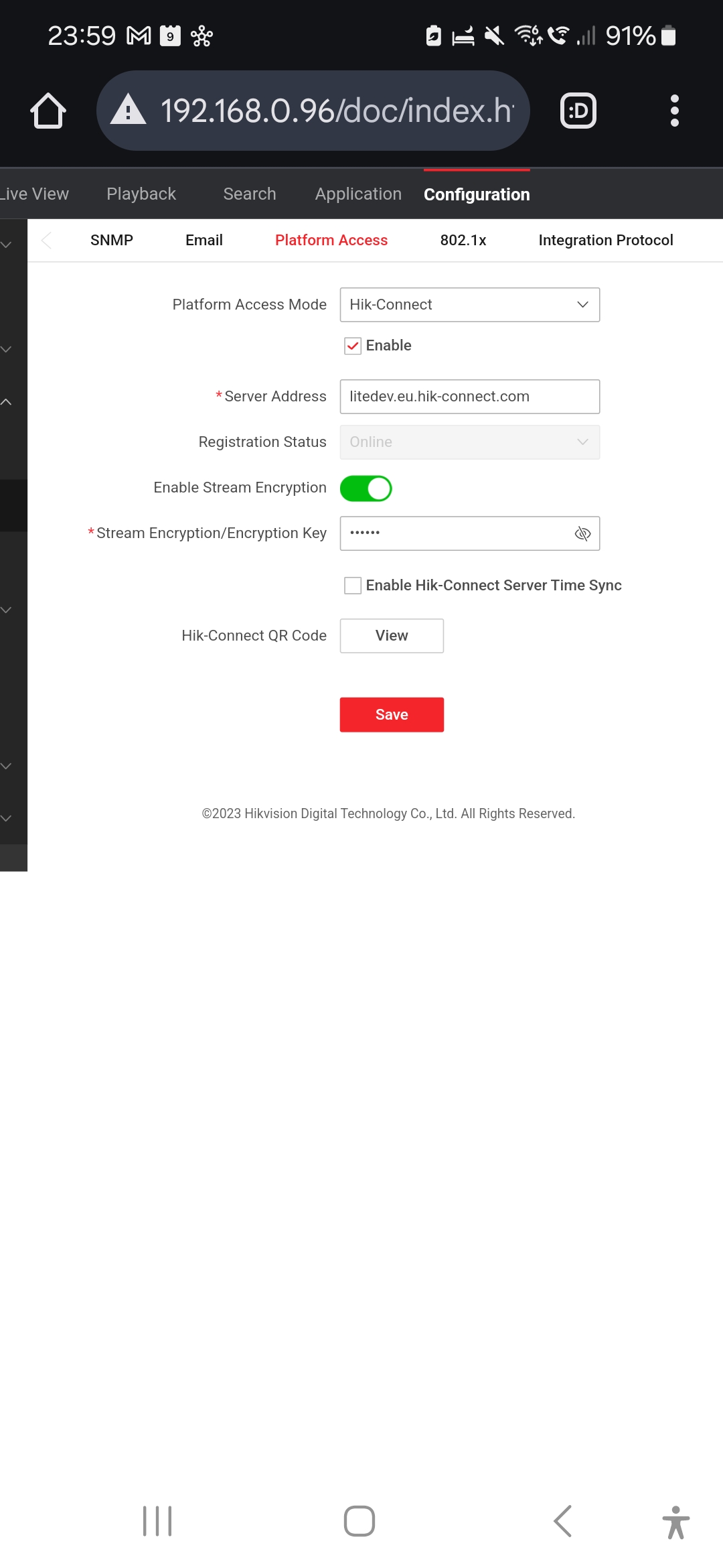

I never use stream encryption which you have turned on. Adaptive Bitrate Steaming may be in the Hik-Connect/Platform Access settings of the NVR

It'll probably clear as soon as stream encryption is turned off.
Turned off stream encryption let's see what happens.
Also cannot find any hik connect platform access settings for the adaptive bitrate, strange
The firmware on your I series NVR may pre date the setting being introduced. As that model is EOL and no longer receives firmware updates (the latest being 4.61.030_240123) if it isn't there now it doesn't matter.
