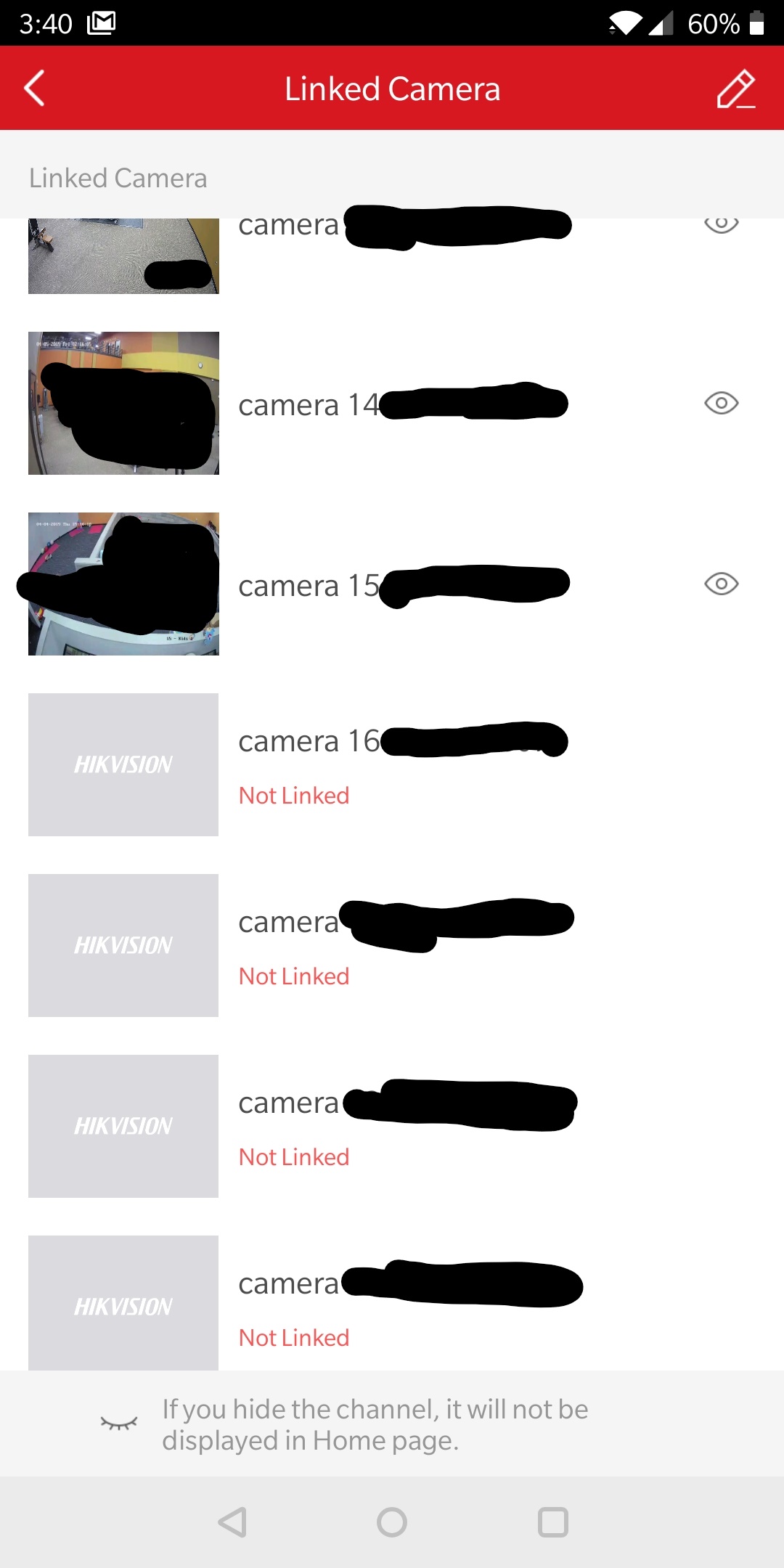

I add some new cameras to my NVR but I cannot figure out how to add them to Hik-connect. When I go to Hik-Connect > My Device > Settings > Linked Cameras - I can see all the channels there, and the new working camera names like "camera 6@N123456", but I cannot add them. I can only edit the name and hide them.
Any ideas on how to add the new cameras? I looked in the NVR thinking there was a place to "link" them but I cannot seem to find it.

I am with you.... They appear there but say "not linked". I can cannot figure out how to link them.
Here is a picture of what I see in the app with the red - not linked text. I even tried to delete and re-add the device to the Hik-Connect account with no luck. Same result. The existing cameras work fine - but I cannot seem to add the two new ones.
Ok, what NVR model do you have? how are the new cameras connected to the NVR? are they directly connected to the PoE ports on the NVR or are they connected to a switch on the local network?
