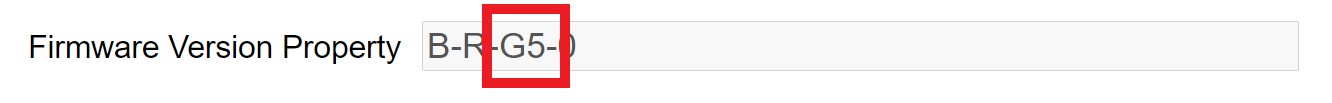

To check if this firmware is applicable to your ColorVu camera, log into your camera in a browser, and go to:
Configuration → System→ System Settings → Basic Information
Applicable cameras will have a "G5" in the third part of the "firmware version property" number at the bottom of this page:
They will also have a (C) at the end of the part number on the white label on the camera or box.

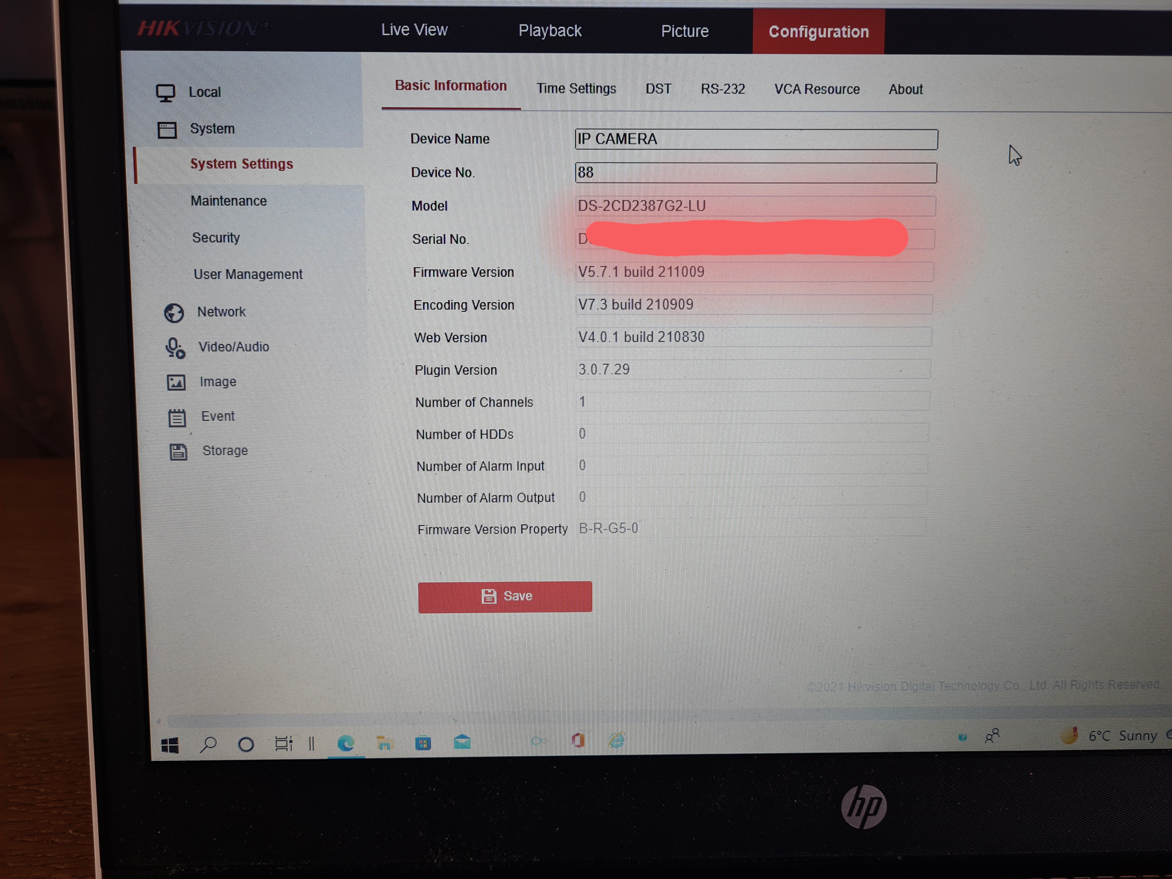

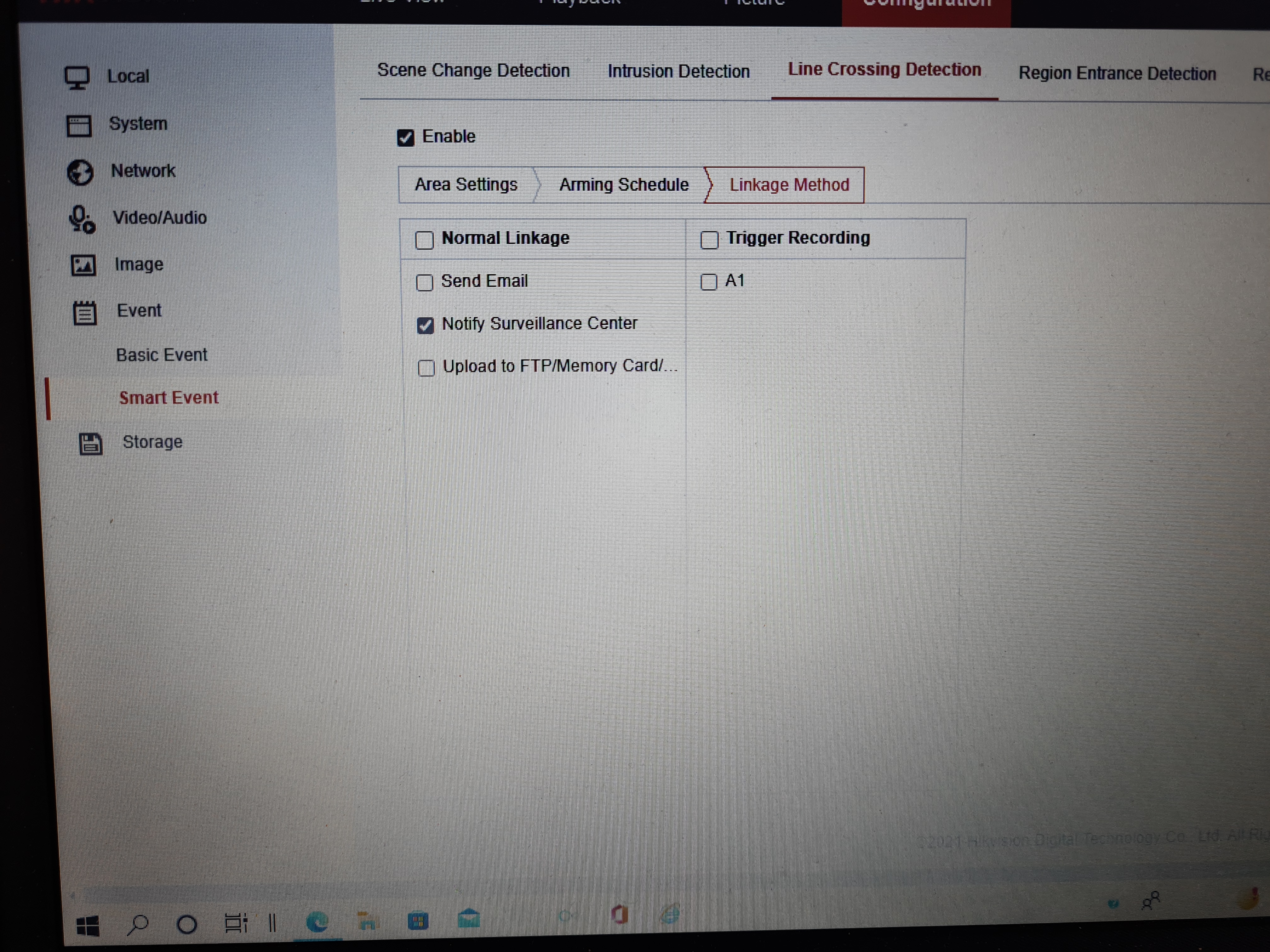

I have this camera and firmware version, however I have no option to have the led trigger.
Can you share a screenshot of the basic information please @Vauxfan - but hide the serial number.
Are you looking in the Linkage Method tab under one of the events' settings, e.g. step 5 here?
Here I think it's what you need.
Thank you.

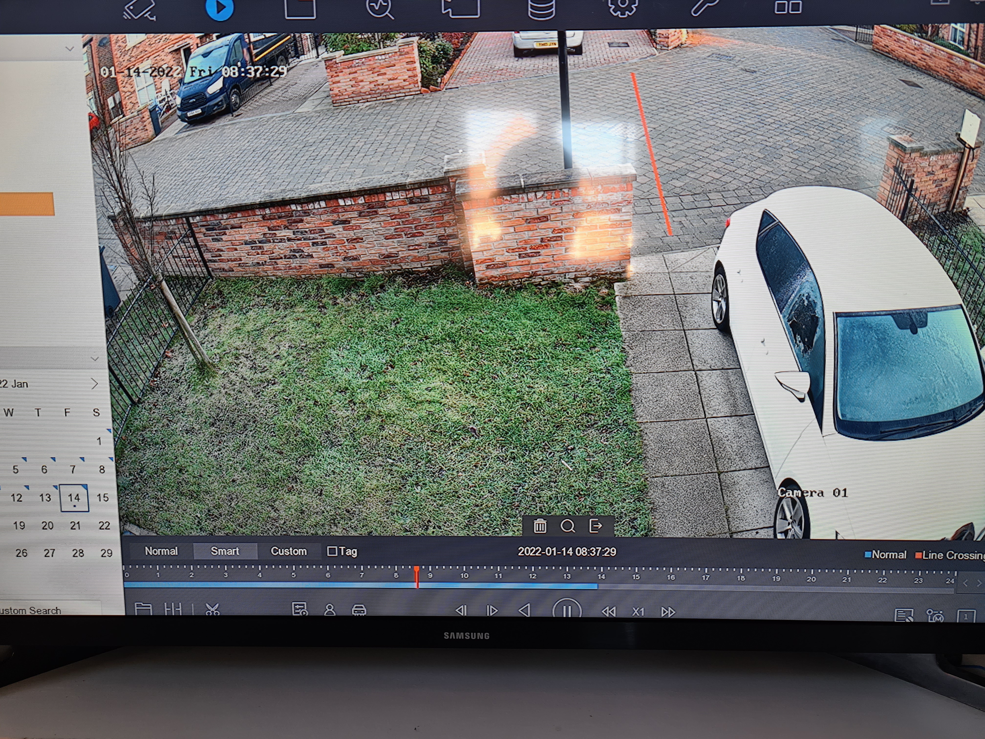

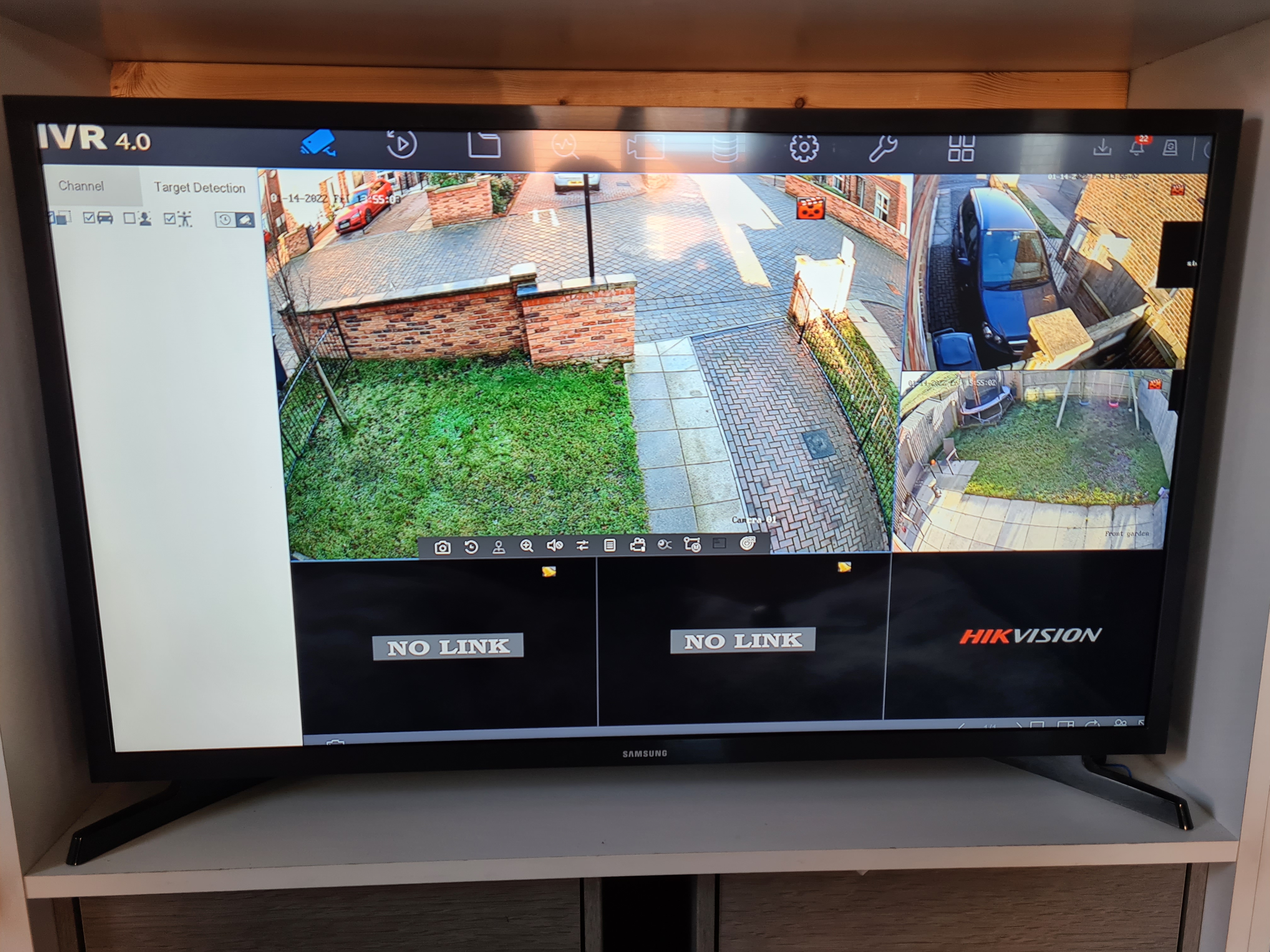

Can you help me with my other issue. Drawing a line on screen and getting no markers. Setting look OK to you? Duel vca is enabled.
