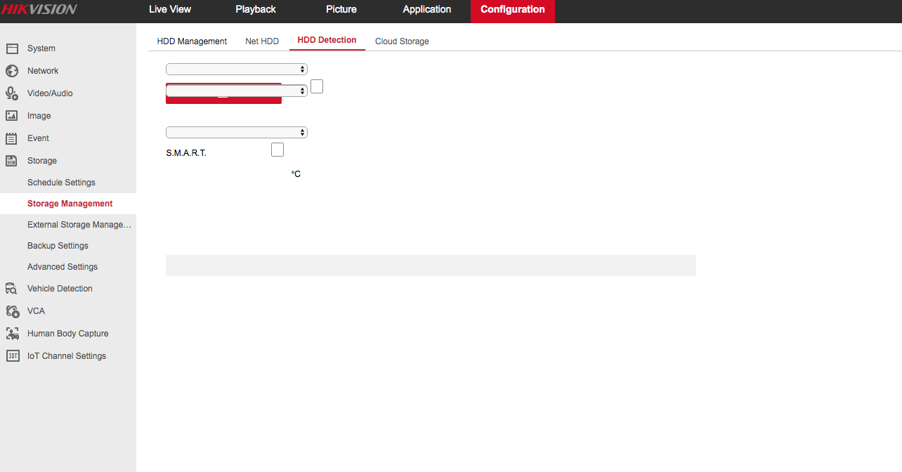

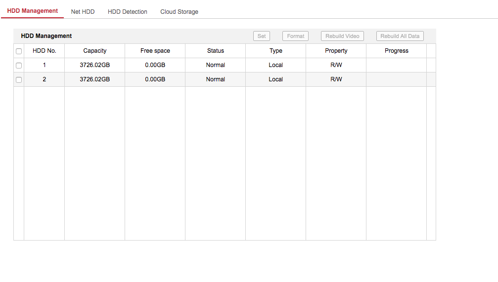

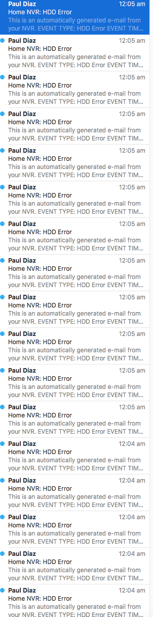

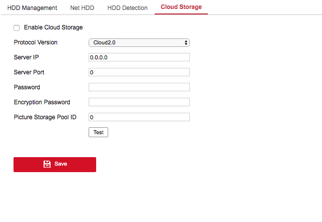

Thanks for sharing/updating.
Interesting new things.
Sorry to see the alarms.
Very odd that it has triggered HDD alarms.
BTW - It is normal for HDDs to show as full.
Email has Stopped look's like it was rebuilding to a new version

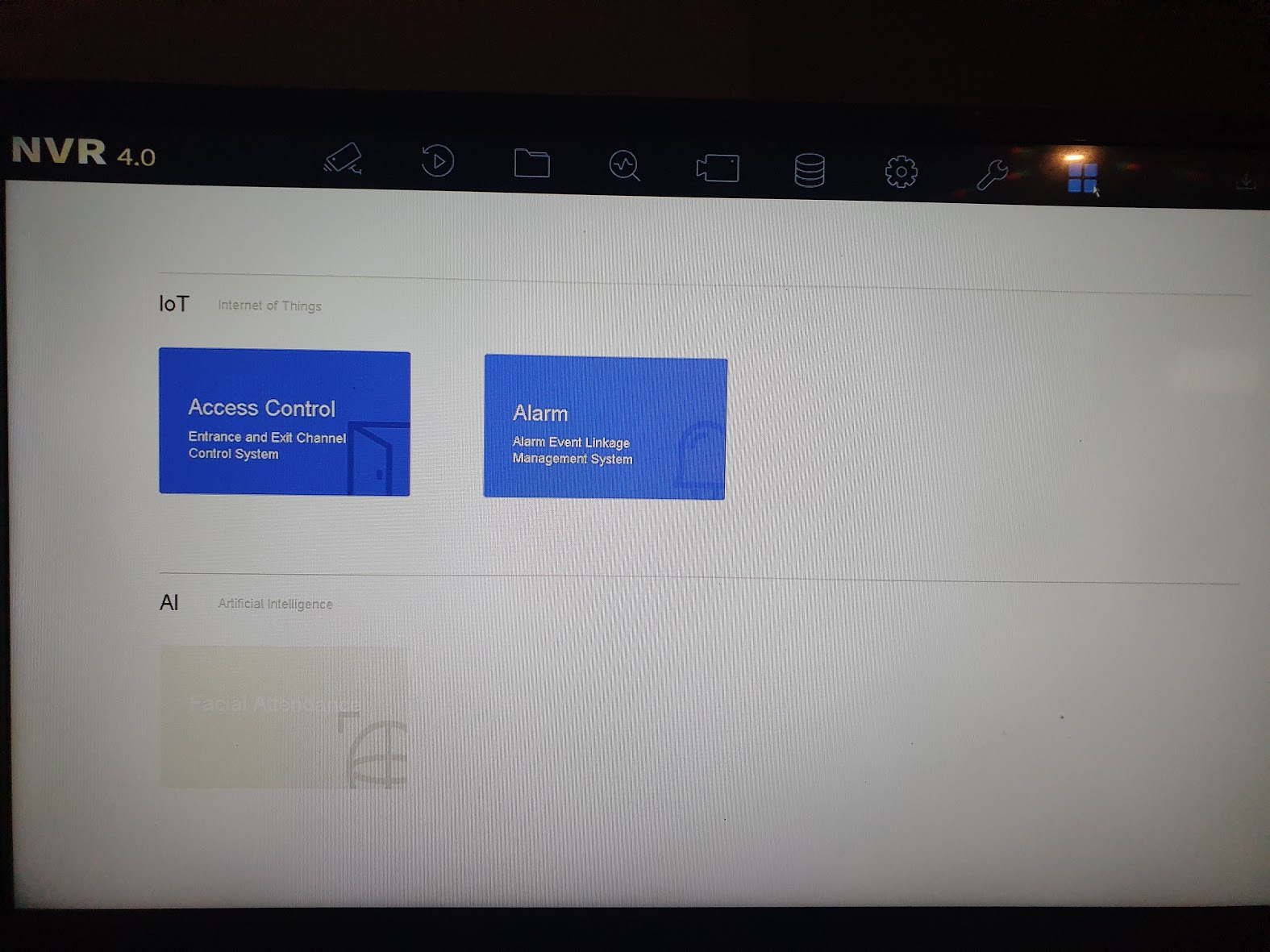

IOT
On the NVR! not sure what it's all about
When or why is is normal for the HDD's to show as full? Neither of mine do that - they change daily when in use to show diminishing storage capacity.
And once they are filled, they will remain full forever, with the oldest data being overwritten.
