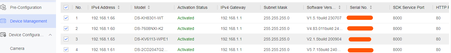

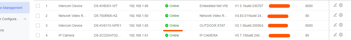

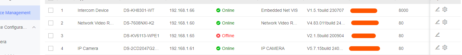

I do not own an -M series NVR or DVR but I have read the issues and work around solutions. I have one DS-KV6113WPE1(A) added normally on NXI-K NVR, and iVMS4200.
What I have noticed with this door station is that there is a problem to add this device only on one Hikvision application called HiToolsDelivery.
The above device is visible in Local Network Online List and same with all other devices, this can be added to Device List.
When all devices are added to Device List then there seems to be a problem with DS-KV6113. Seems like the program does not accept 80 as the HTTP port:
By editing the HTTP port to 8000, the device is normally detected as Online
I don't know if the issue is related with the issue you all face with new -M series firmwares
The indoor station has similar issue but this is automatically added with port 8000.
