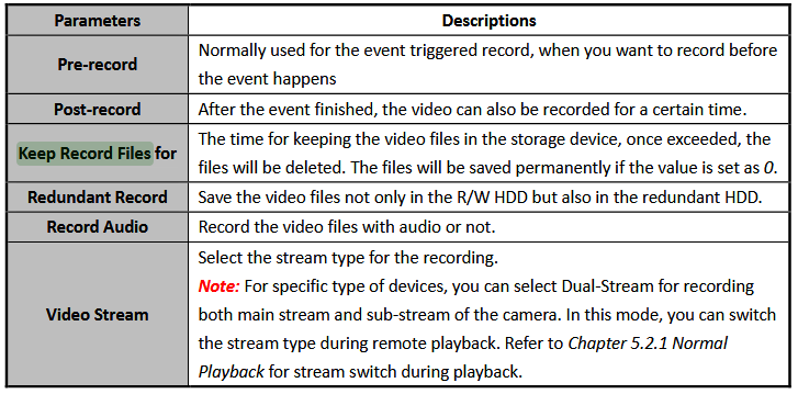

And in the iVMS Manual is clearly described:
I have created 6 100Gb volumes on the Synology NAS, and addressed each of them propelry on iVMS-4200. Schedule and recording are fine, but there is no way to restrict the number of days recordings are kept. This may cause trouble with the new privacy regulation (GDPR) where the perido of days a registration is maintained must be communicated.

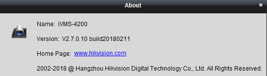

But a new version has been released on the Hivision Download Portal: 2.7.1.4!
I will install it and let you know.
Thanks for your support.
